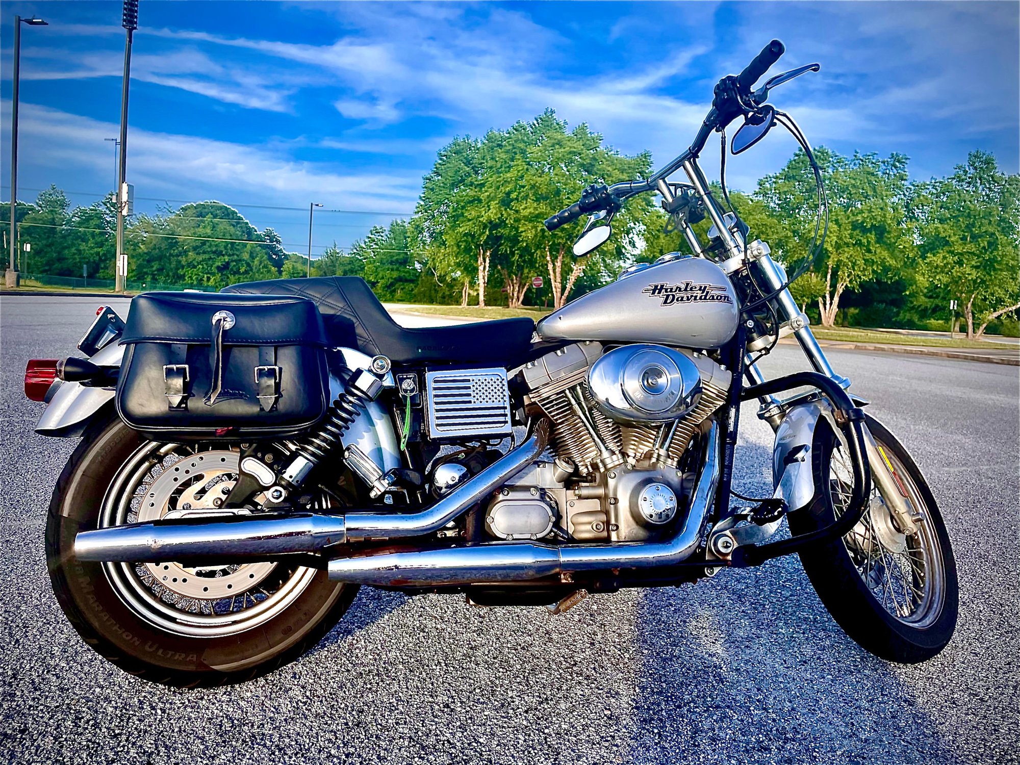

Post a pic of your bike.... Need ideas
But good luck with what you do.. It's a fun process
so far I’ve done t bars, daymaker headlight, upside down mirrors, MX style foot pegs, saddlemen step up seat, saddlemen bags, low profile turn signals
next up is air intake, 2 into 1 exhaust, Memphis shades fairing and some kind of lower profile rear brake light solution

Looking good sir... Is that the stock front end? Doesn't look like a 39mm
