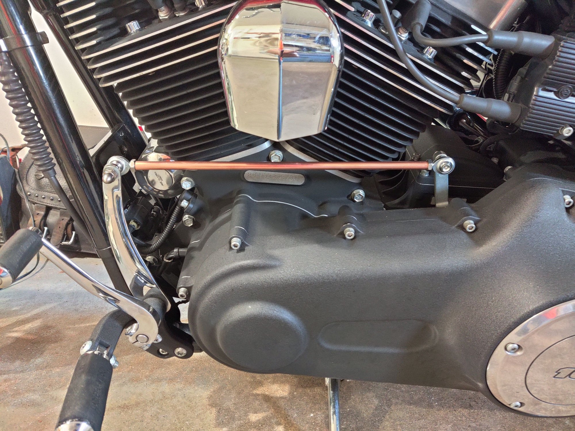

I'm in the process of making one. Bought some heim joints off of Amazon and had a nice piece of thick walled copper pipe that I tapped.. As soon as the joints come in I'll post it up.. here's the joints from Amazon

Little update.. Had to send the Heim joints back. They we're junk.. will have to get another set..

So here's what I came up with for a finished product.. Lighting in the garage ain't the greatest.. Might be able to get a pic when outside in the sun later today...
Excellent! Nice work.
