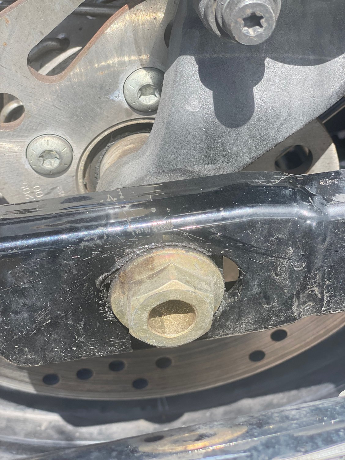

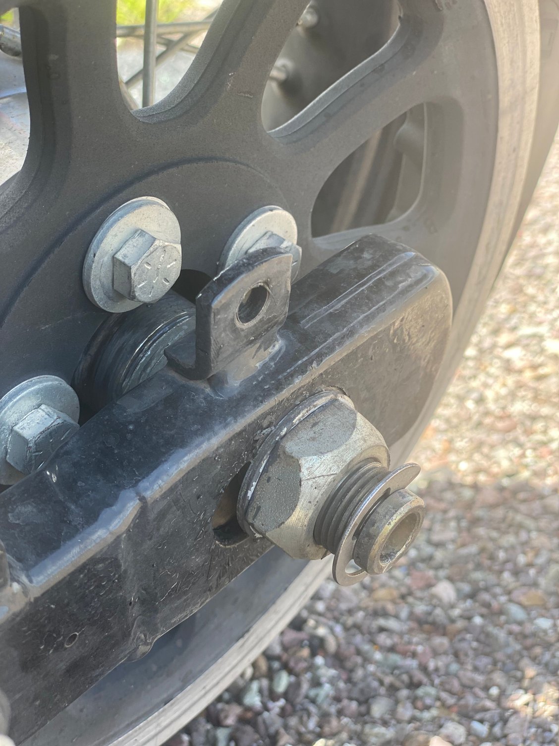

Had the shop install, mount and balance my rear tire.
Rode it for 2 weeks straight then went on for a 6 hour ride to which my bike started weaving side to side 4 hours in.
looked at my rear wheel while rolling, both rear axle nuts are spinning. They spin forward when going forward and backwards when rolling back.
It looked like the axle was spinning outward to the left. But some say it could be the bearings locked up.
See pics.
Thoughts?

Pull it apart and find our.
Zooming in, the seal definitely appears to indicate a bearing issue on the caliper side. Drive side really is not visible.

"But some say it is the bearings locked up."
I suspect the nut has come loose or wasn't torqued up properly to start with.
I would think with the nut done up to 100 foot lbs a seized bearing would just destroy itself.

I agree with @Andy from Sandy , since it looks to me like the nuts aren't tight enough, so they're rubbing against the swingarm, causing that arced "wear" around them. I'd definitely check the torque on them and make sure it's right.

Bike is at my buddys house 6 hours out. Waiting on him to pull it apart.
Bearings never changed since I bought it around 20k miles, it now has over 33k.

Man I hope that’s just the problem. Gonna have my buddy add new bearings and grease just because.
