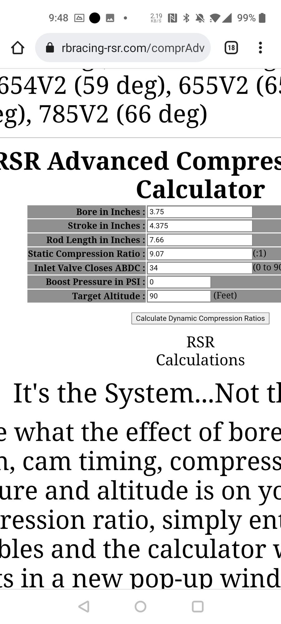

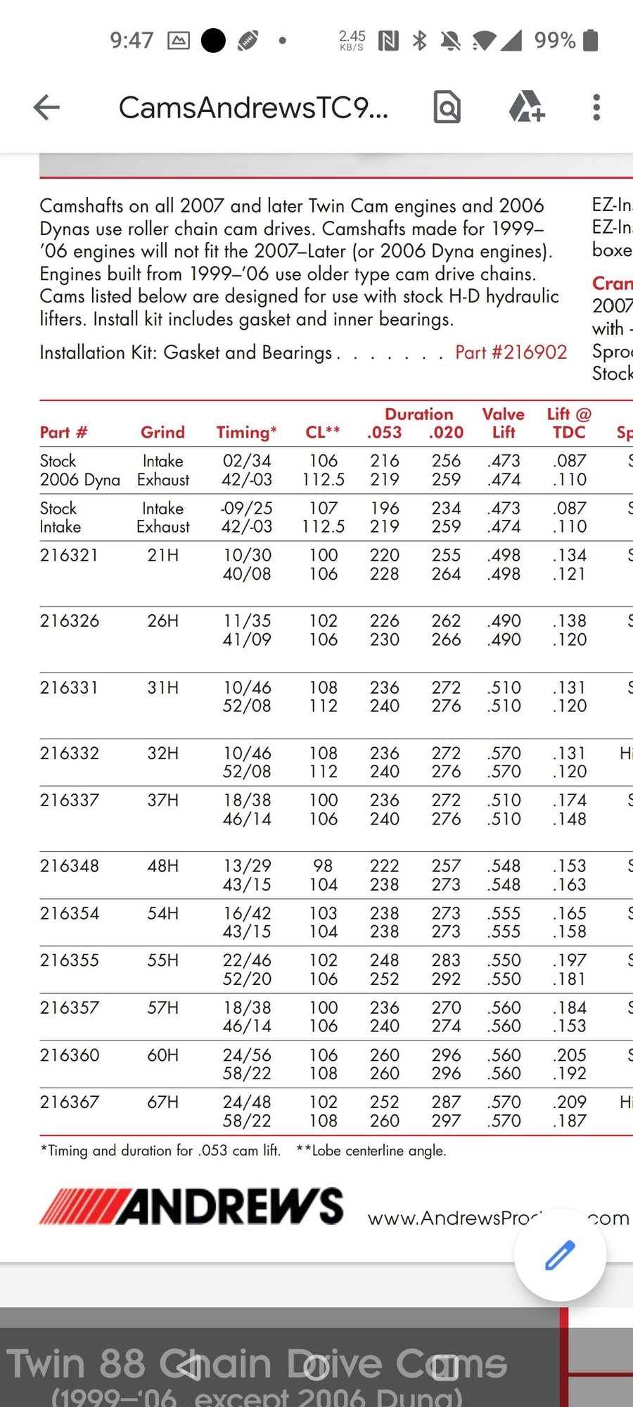

Not trying to step on toes here but I don't want to mislead the OP..
Based on your calculation of 9.07 static compression with the "STOCK" IVC of 34*
With those numbers punched in to the RB Racing advanced compression calculator or Dynamic cranking compression ratio based on an IVC of 34*
It still only comes up to 172 CCP...
Not sure what IVC timing you are using....
Actually those CCP calcs are for a 0 degree intake close. It a woods W000 cam.
