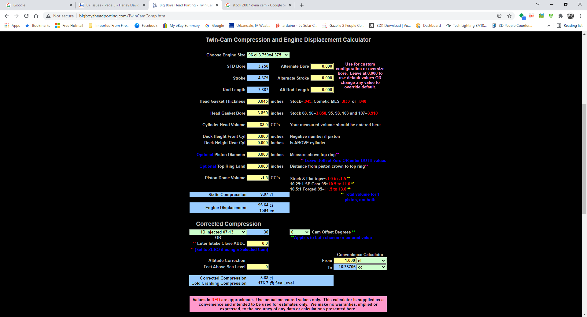

Actually those CCP calcs are for a 0 degree intake close. It a woods W000 cam.
Not following Max.. can you elaborate a little more..? Thanks
Probably more directed to Jay. His compression calc is based on a 0 degree intake close.
BTW Static compression does not change on intake close. It's the same no matter what cam is chosen.. Corrected is what changes.

That's what I thought but wasn't quite sure.. thank you..
Thanks, my bad
