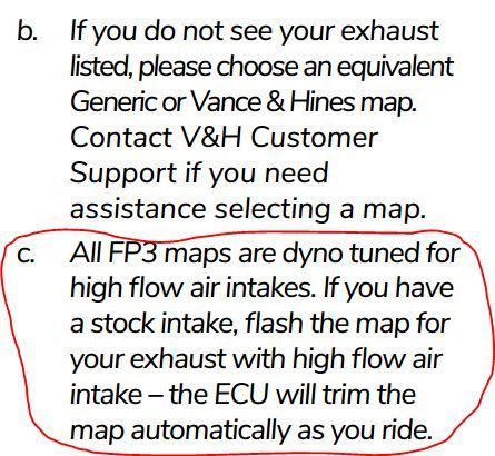

All FP3 maps are built using a high-flow intake and the Delphi ECM will trim accordingly if you do not have one installed.
If you later install a high-flow intake just flash the same map back again and the trim will be reset (Adaptive Fuel Values).
We have FP3 on two 2014 FLHXS bikes and we recently installed Zipper's Rushmore intakes and did just that and all is well.

It's my understanding that once a FP3 is married to a bike/VIN it can't be used on another bike. So finding a FP3 on the cheap, as in used, maybe a bit difficult. I opened my app and used your information, it's doable for your 2010 Dyna.
