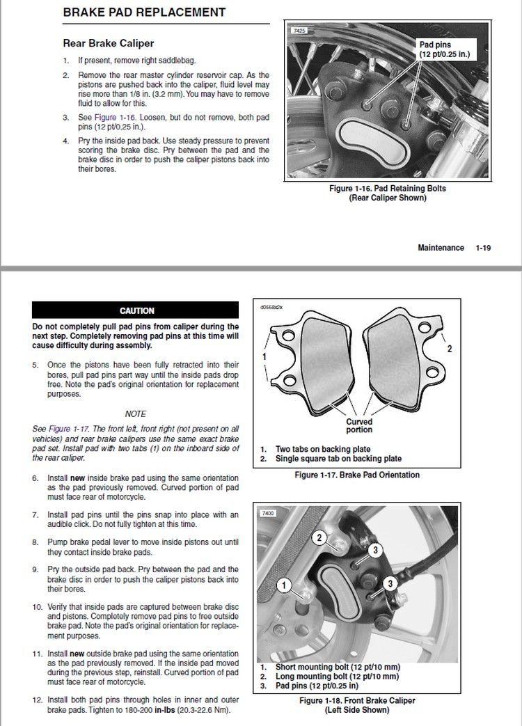

Oh...I didn't realize I could change the pads without removing the caliper. That was my concern. Gonna have to research that.

Here you go ...
