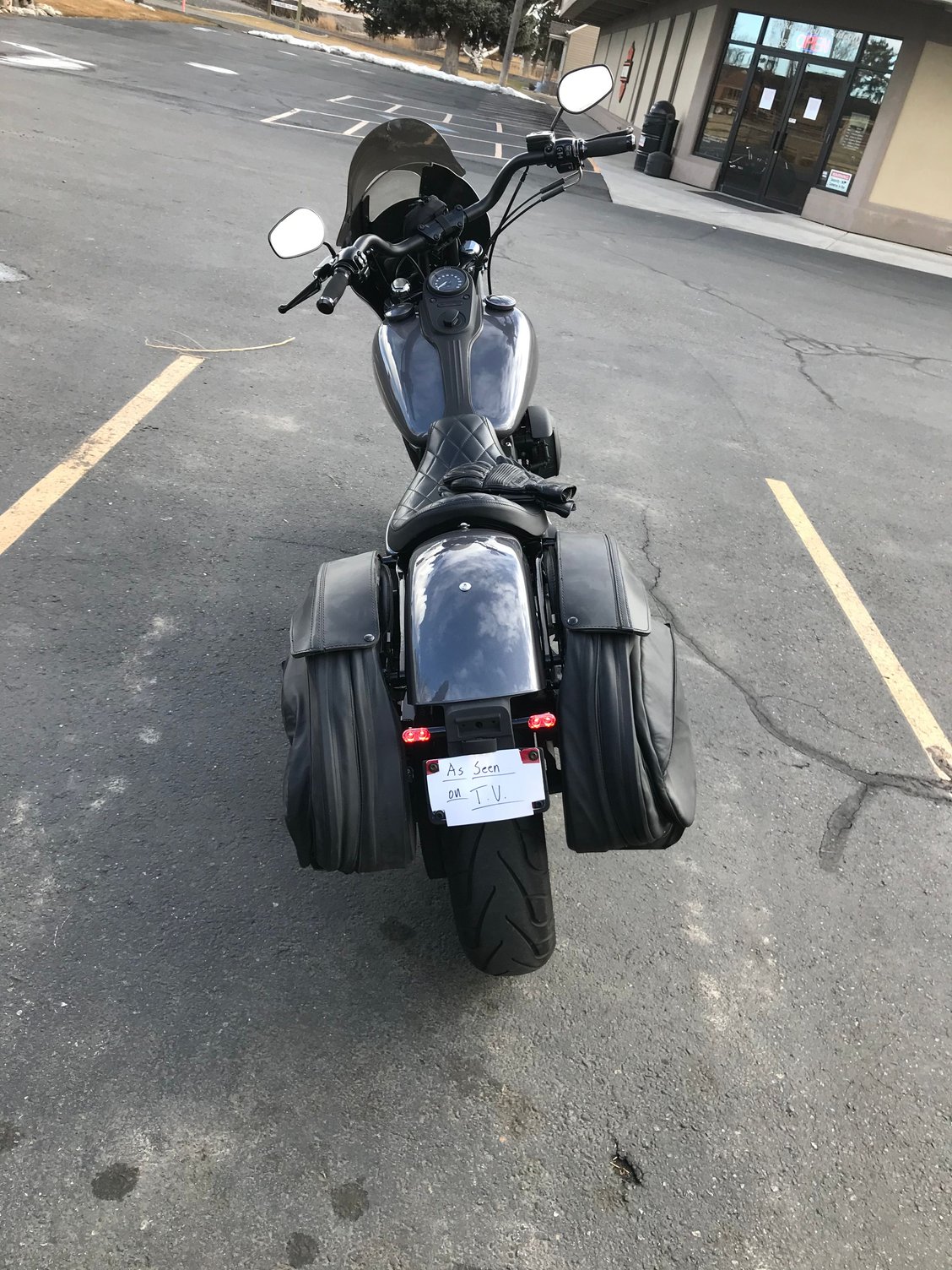

Here's just some food for thought, top one is Arlen Ness LEDs on a HD L/P mount made for plate relocation since the L/P mounted on the left side swingarm originally (I modded the mount to take the lights); bottom one is a Custom Dynamics LED L/P frame on a mount I made.

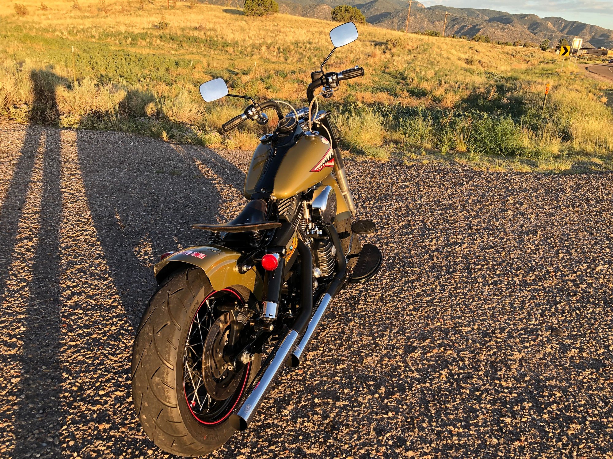

I chopped the rear fender on my 2007 Street Bob and got rid of the taillight. A Custom Dynamics Smart Triple Play module will do the trick. It makes the turn signals work as taillights, brake lights, and turn signals. When you're just riding, the turn signals are half illuminated as taillights. Hit the brakes, and they light up as brake lights. If you hit the brakes and a turn signal switch simultaneously the one side flashes and the other side illuminates as a brake light. The module doesn't care that there's no center taillight/brake light plugged into the system. I've been running this setup for years.
