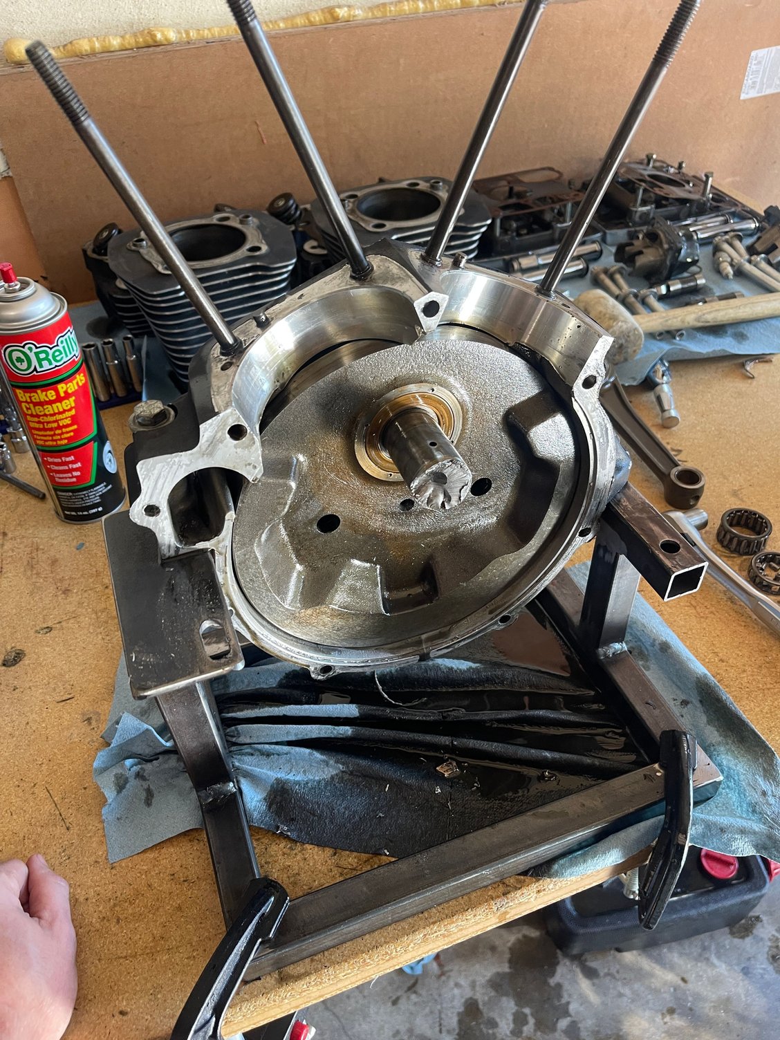

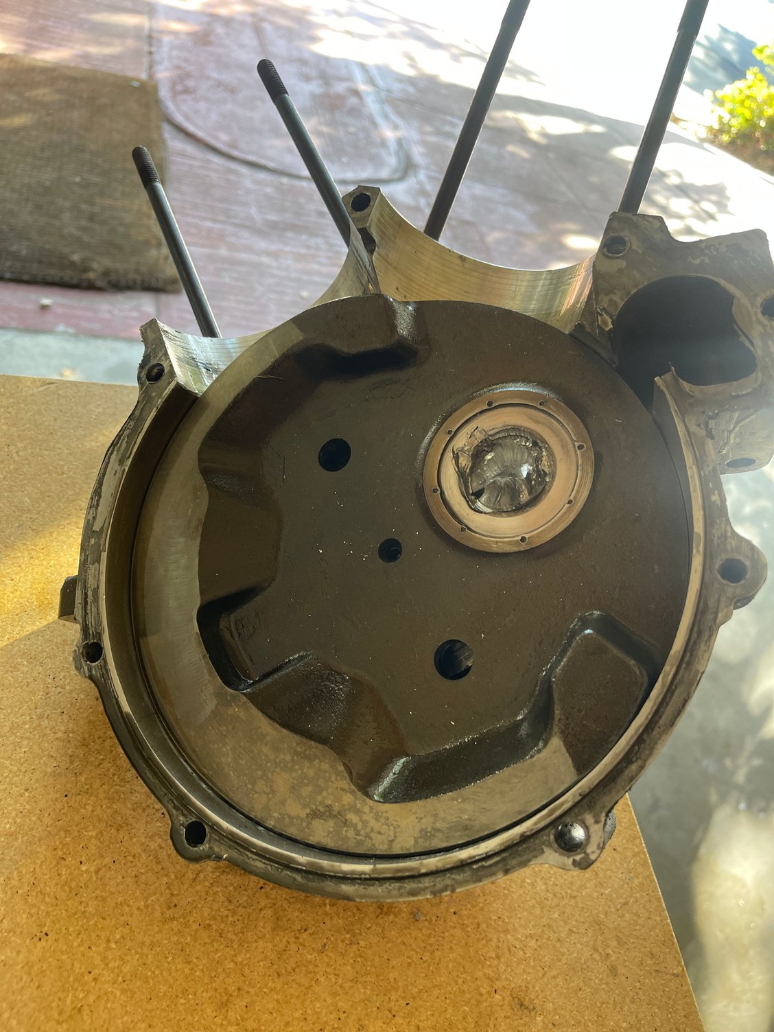

Sheared a crankpin on my evo a few weeks back. Pics attached for entertainment. Pretty interesting stuff. Got a remanufactured crank and she's all back together now.

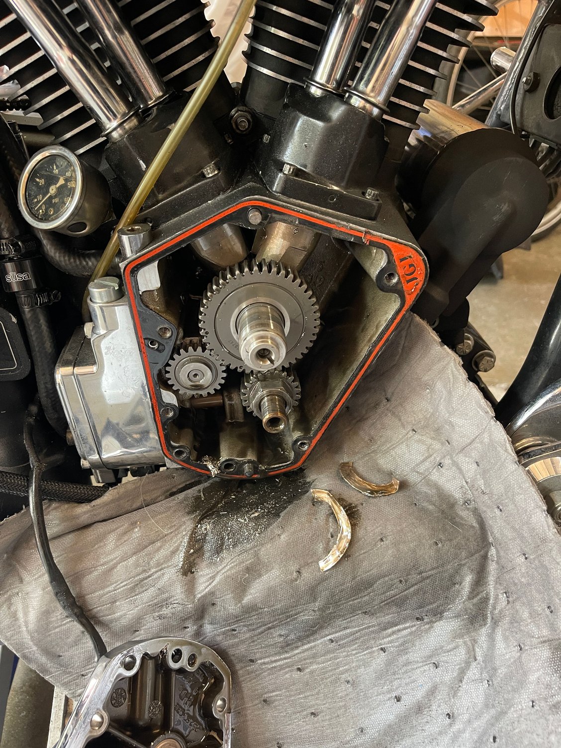

I then remembered that I pulled some kind of shredded copper washer out of the gear case upon initial inspection.
Am I correct in assuming that this washer came from the side of the flywheel where the crank sheared?
Thanks in advance.

Looks like it's the missing crank pin thrust washer. You can see the other one in the first picture.
