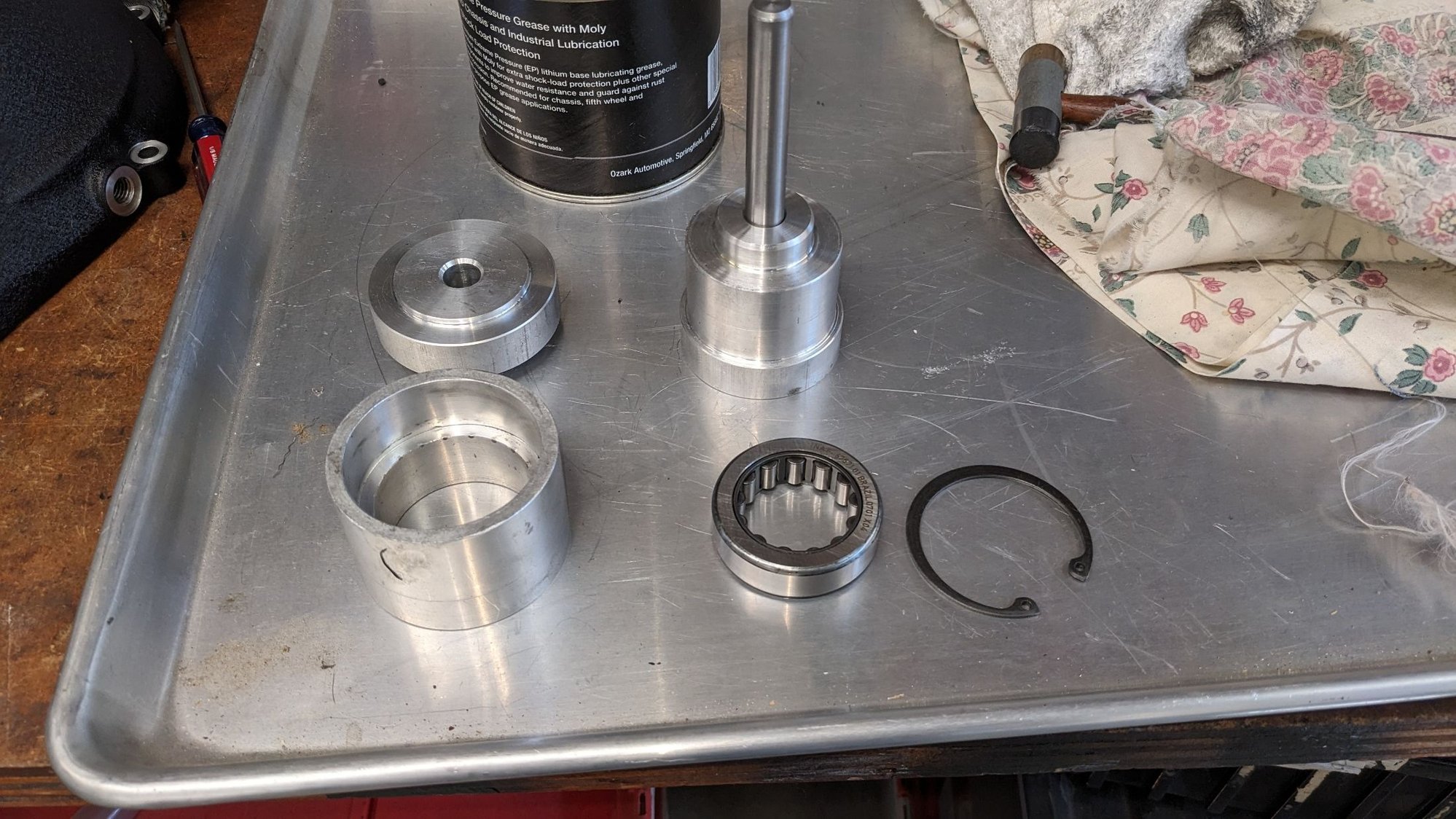

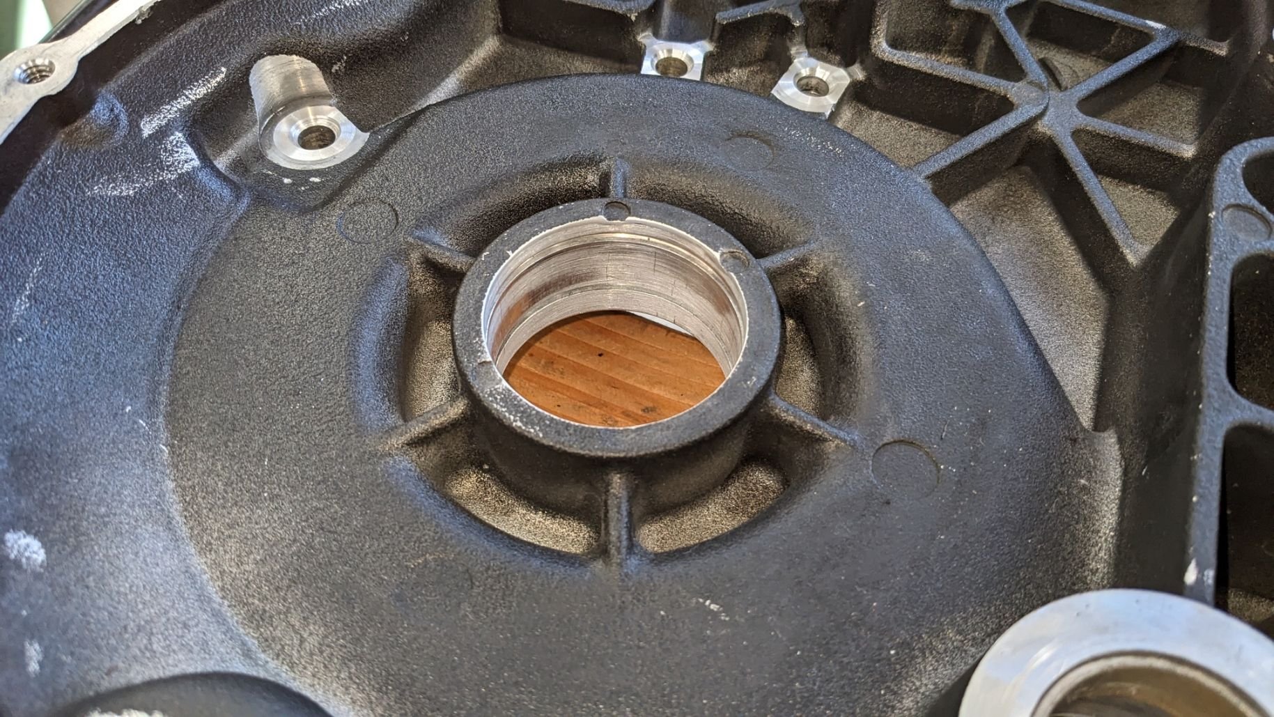

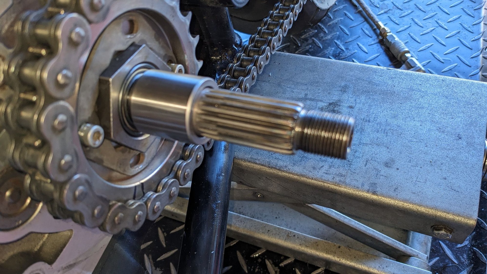

While I still had issues with starting and will get back to it but I also had to clean some stuff with the inner primary..
Some time ago I replaced the inner primary bearing and got it cocked. It misshaped the case. I figured to clean it up and make sure it was straight.. I made an RnR tool to ensure that the bearing was straight.

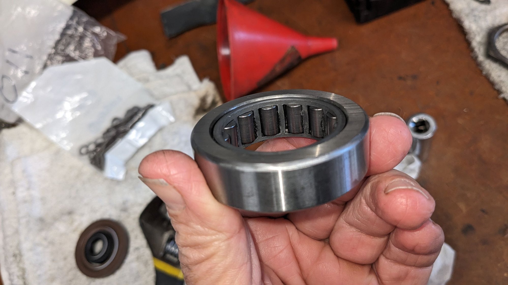

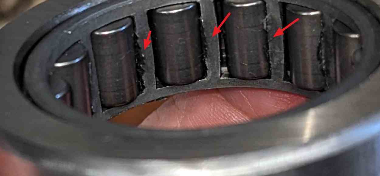

Notice that the bearing cage burrs that stick out, I wonder if this was caused by the race being distorted and causing the rollers to be forced up against the cage..

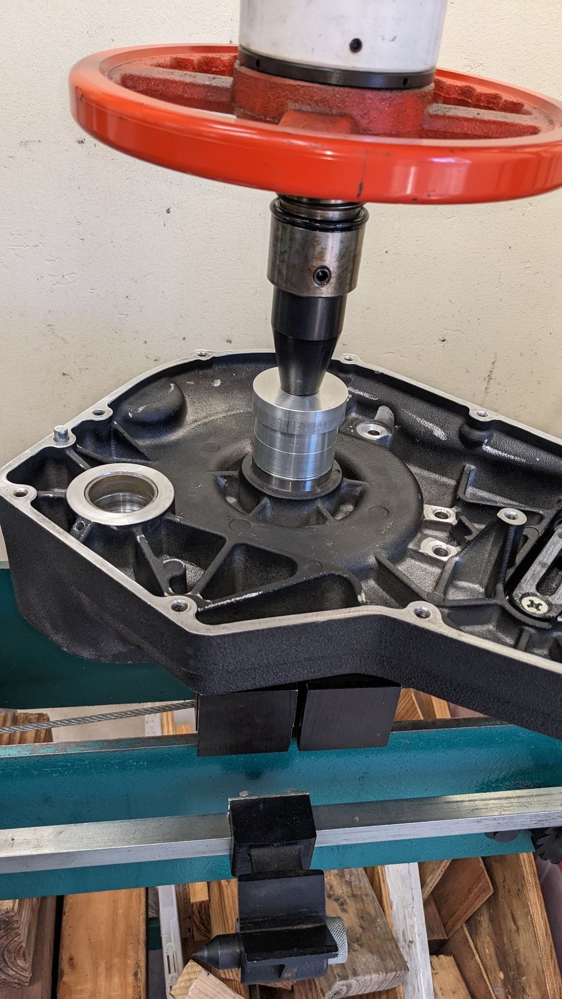

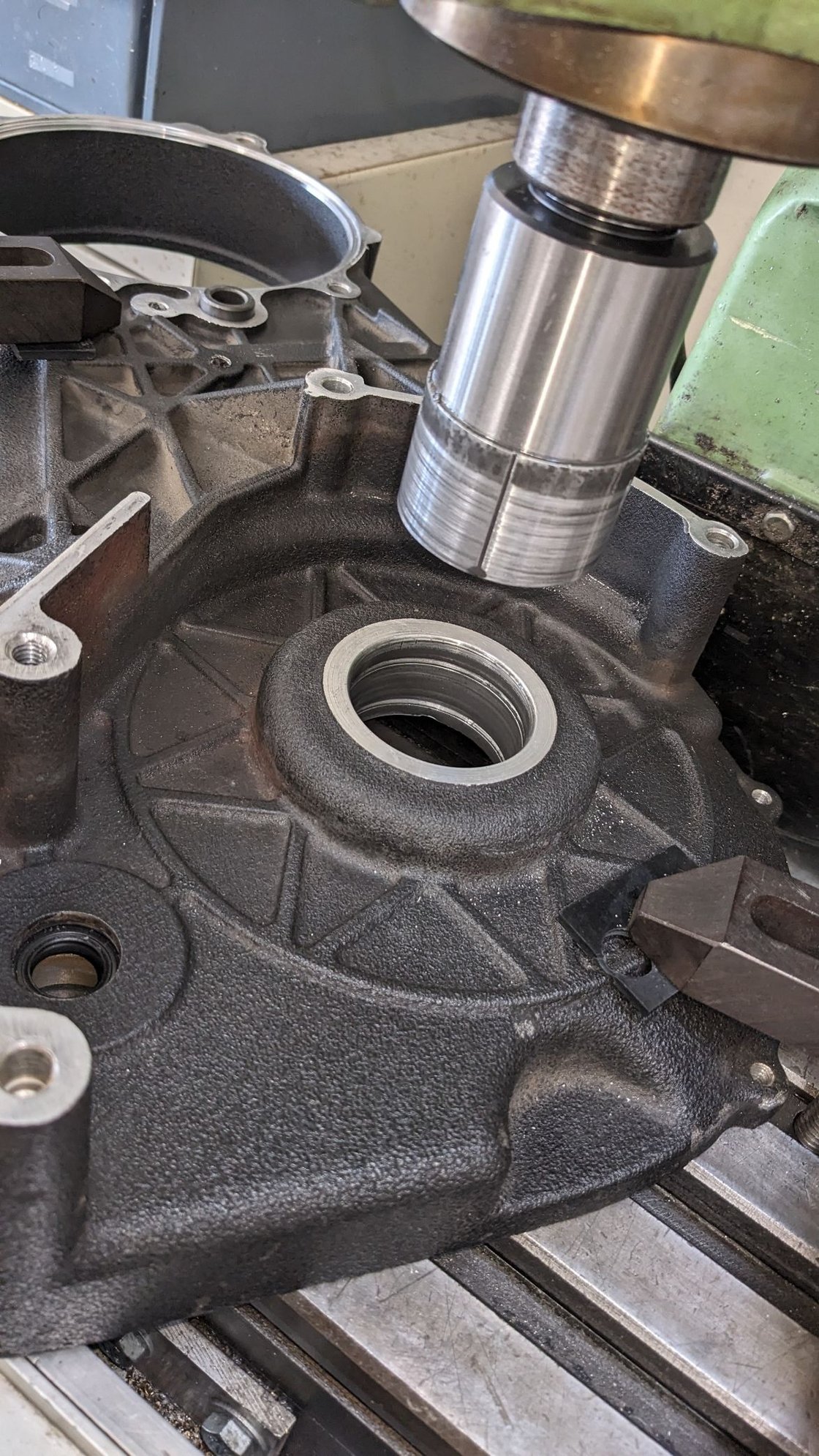

So in order to make the bearing hole reasonably straight, I needed a lap. Didn't have one so I made one out of a endmill holder and a press fit piece of aluminum. Had some pipe and turned the ID to a press fit on the endmill holder then turned the OD so it was a snug fit in the case bearing hole.. I ran it with oil until it ran smoothly then added some lapping compound to grind a little more.. I ended up with about 0.0015 press fit and the hole ain't perfect but bearing lined up much better.

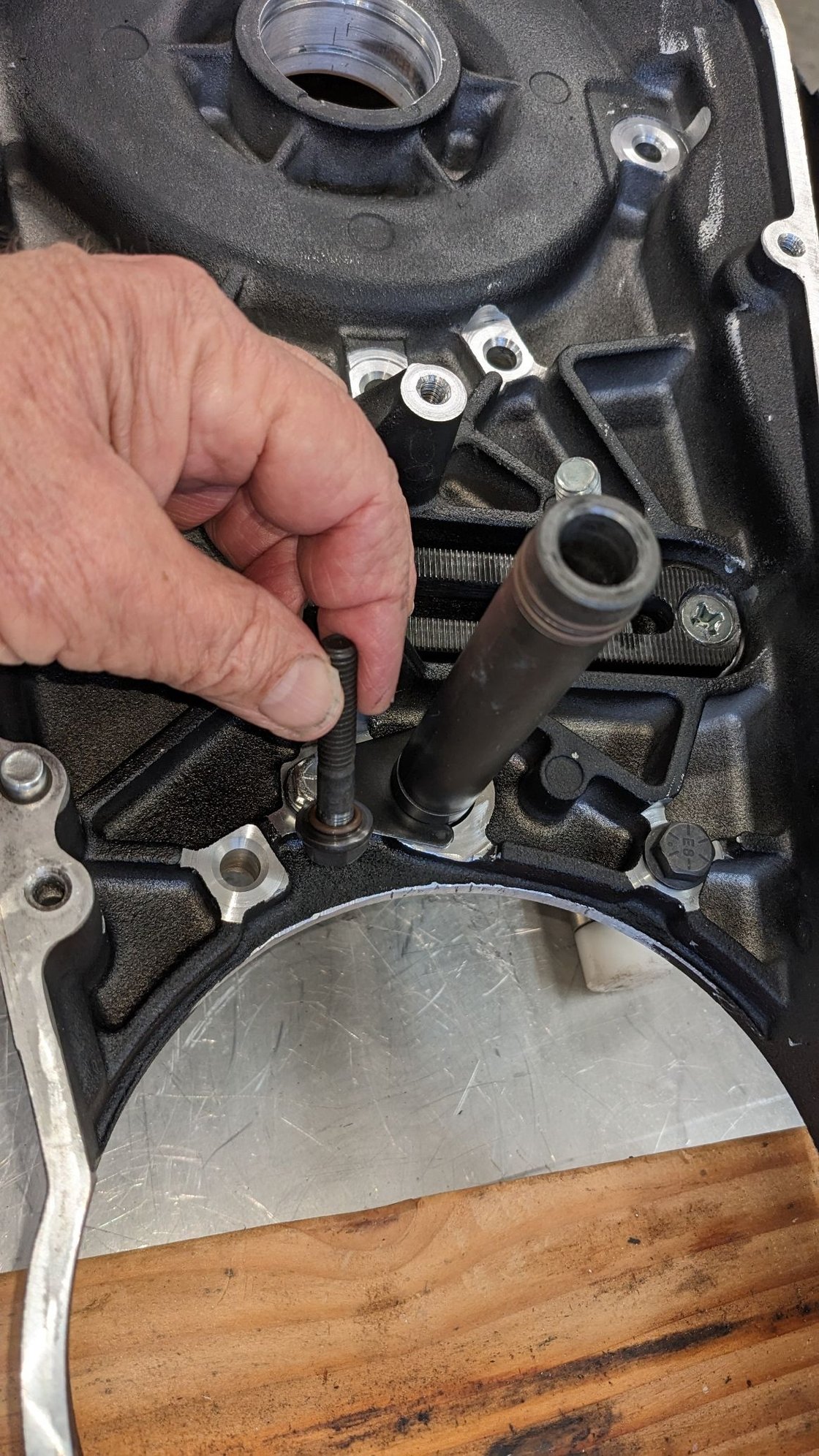

I also went back to the SnS inner bearing race to stop the walk.. I also cut tapers in the inner primary bolt holes and used shoulder bolts to keep oil from leaking down the bolt shanks.
