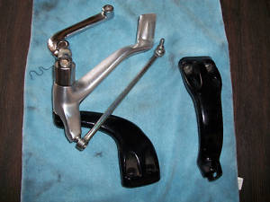

I bought mid control brackets off e-bay that came off an 06 street bob. I am going to use them on a 2010 WG for foot rests. They look like sportster brackets to me. They are not the brackets I want but will they work?

They look like the brackets on my '06 StreetBob.

Just take the brake hardware off and bolt them up, attach footpegs and off you go.

They look different than my FXD, but that might be expected.

Well I tried to put the right side on and it will not fit. It hits the pipe ( python 2into1). Or any other exhaust I have that will fit my bike. So I guess I need to keep looking for the other style brackets. However they did clear the exhaust on my friends 06 sportster custom.

How much do they hit by. Maybe just a spacer block and some longer bolts would work.

The way the bracket is it would have to cut through the center of the pipe. I need a bracket like on my wifes 07 lowrider, its designed to clear the front pipe.

Those are not the ones you need. I have FXD mids for sale if you need them. They are black wrinkle BTW.

Oopps, I went back and looked at the pic. they are different than mine. Sorry, I'll just keep to myself.
