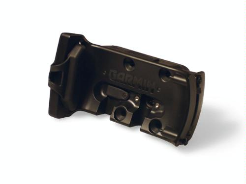

I use the ZUMO 550 in my car and on my bike for three years now.
I mounted the ZUMO mounting bracket to a chrome Kuryakun mounting bracket (p/n 1421):
and put it on my handlebar, which looks like this:
I ran the wires (+ has a fuse) along the neck under the tank. To get them into the tank tunnel I used a piece of thin plastic coated metal wire and inserted it into the tank tunnel from the battery side. I bent an eye into it and pulled the GPS wiring towards the battery and connected the wire ends directly to the battery studs.
