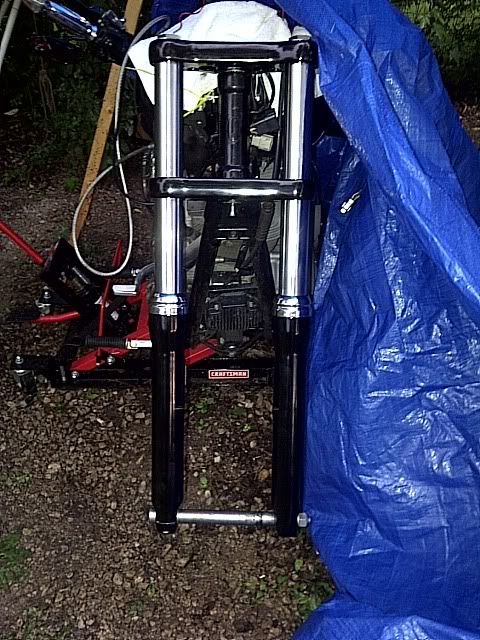

Old Jun 17, 2011 | 07:27 PM
stev0n's Avatar
stev0n
Joined: Jul 2010
Posts: 764
From: bowling green, ky
Well picked the parts up from the powdercoater today. ended up being a 6-day turnaround.
Here it is put back together. storming bad here so I can't finish til tomorrow.
I don't wanna take anything away from Joe (the powder pro) cuz I respect the hell outta the guy. But if you live near bowling green, ky give em a call - it can't hurt.

Old Jun 17, 2011 | 07:43 PM
force49r's Avatar
force49r
Posts: 329
Looks great! Gonna do my tree's this winter. I tell you something, that powdercoating parts is addictive as hell! I still need to post last winters mods, lots of PC, including my wheels! For some reason I didn't think about them when I had my front wheel off.
