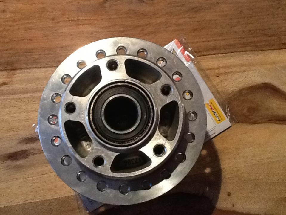

Hey guys need your help,
Are the 2010 Street Bob and Superglide front hubs the same size?
I'm trying to put the Superglide hub on my SB but I can't seem to fit the original SB Spacers (they have the same length).
Are there different Bearings ?
The hub is for dual discs like the SB is the # and letters I can see on it are 17306, HD, H47, 1 and 216N
Need help fast thx.

Old Feb 11, 2012 | 01:56 PM
2sharp's Avatar
2sharp
Joined: Nov 2009
Posts: 62
From: Germany
Default hub
here are some pics

I don't mean off a Wide Glide but there are a number of others that use that hug width - I measured my old FXDC and while not a precise figure, mine measures 5" or 128mm bearing to bearing.
Old Feb 12, 2012 | 10:54 AM
2sharp's Avatar
2sharp
Joined: Nov 2009
Posts: 62
From: Germany
So I just got a Mail from the guy that sold me the hub. It's definetly a 2010 Superglide hub.
I'm wondering if there are slimmer bearings installed in the 2010 Street Bob hub.?!
