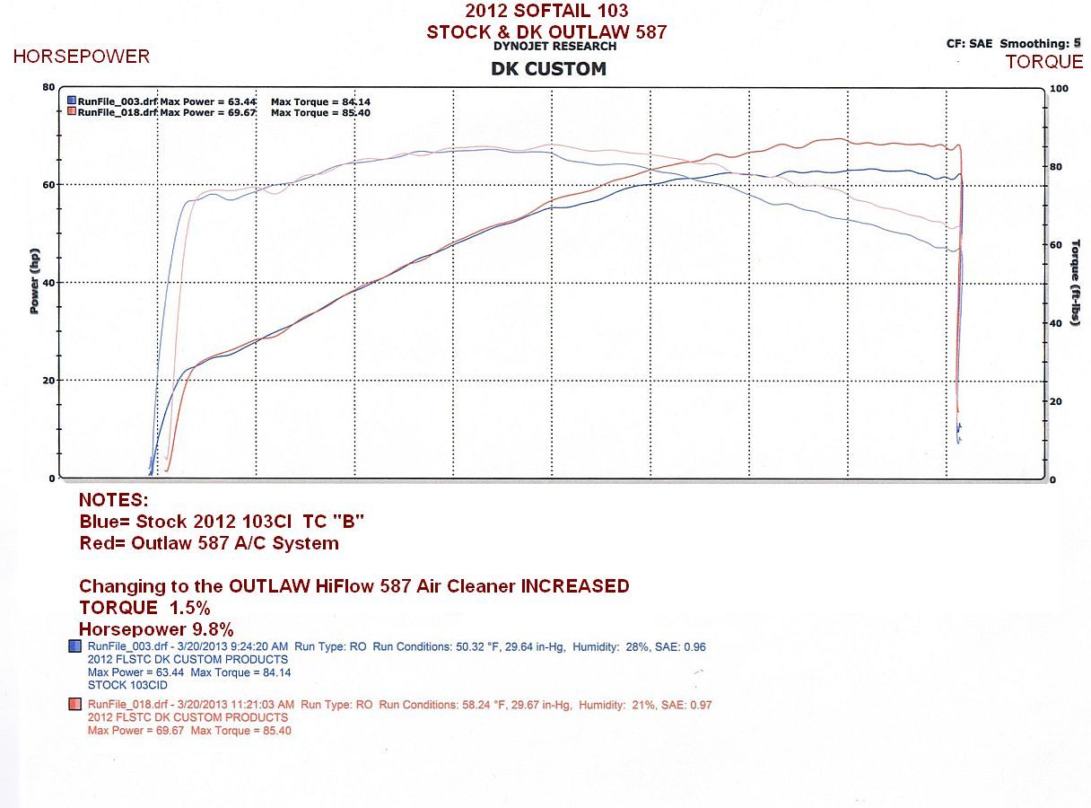

Just an Outlaw 587 upgrade increased horsepower almost 10%
A full Stage 1 with the OUTLAW is an even more dramatic increase-

HOLY CHIT,,, a stock 103 is making 63 hp? looks like cubes are going up and hp is going down......
