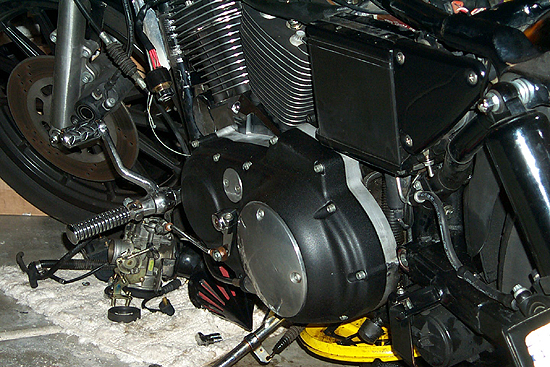

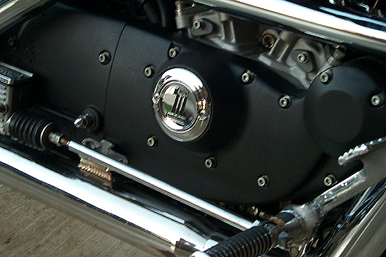

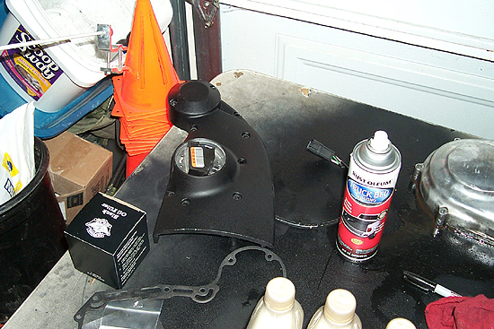

I found a pretty passable replacement for wrinkle black powdercoating is spray on truck bed liner paint...
Off my Sportster:
I just scuffed the surfaces with 800 grit to help the paint stick and sprayed a degreaser on it to clean it then layed down a good couple coats of high temp primer followed by the bed liner. The stuff is very durable. I got hit on this bike at 50 on the freeway by an SUV after this was done and the forward control on the left side hit the primary cover hard enough to put a hole through it that's about 3" long. The paint around the hole did not get scratched or flake off! The only spot where some of the paint came off was one little dime-sized spot next to the derby cover which probably hadn't been propery degreased.
I don't know how it would stick to chrome...or if you're going for the wrinkle black kind of look...but it's an option.
