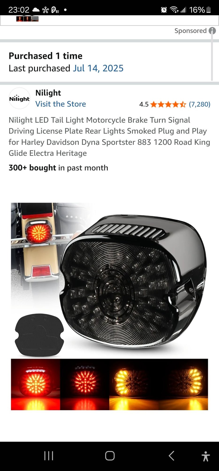

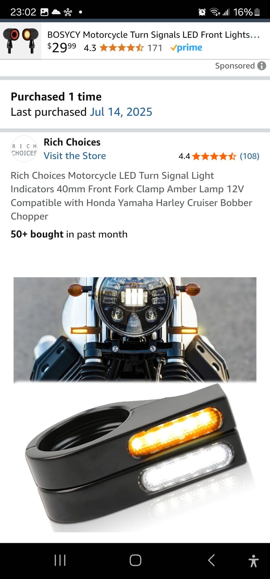

True, i am running an Amazon tail light that functions as turn signals. In the front im using again amazon Led pods that haven't been connected yet that bolt to the forks. My right side front and rear functions completely normal after installing the resistor. Left front receives running power, no turn signal power. Rear left stays solidly lit with inline resistor which gets ridiculously hot.

I have never heard of "Nilight" or "Rich Choices" for Harley parts, so I looked them up. AMAZON!!!!! Sorry to say, ya got what ya paid for, cheap chineseium crap.
