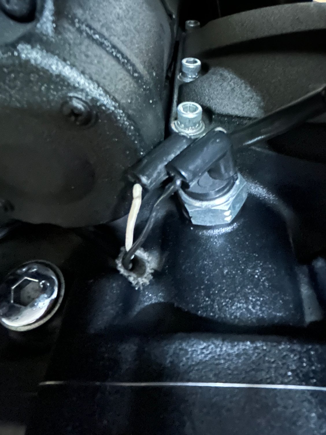

Originally Posted by Schex
Like this, you’ll have to add loom if it doesn’t move to the connector.
Schex, I never noticed that my wires are North South, yours both the same way and looks much cleaner. In the service manual it says to remove main fuse when replacing the neutral switch & put in Neutral. If I'm just popping off the white one to spin 180 degrees there's no need to remove fuse I'm guessing? also, I'm assuming a straight up pull to remove? I don't want to brake it. Thanks man, I have never messed with that part.
*EDIT* I just Googled and my suspicion was answered by Doc Harley, they pull off like a spark plug, before anyone wise asses me I didn't want to ***** it up as I have never tinkered there LOL
