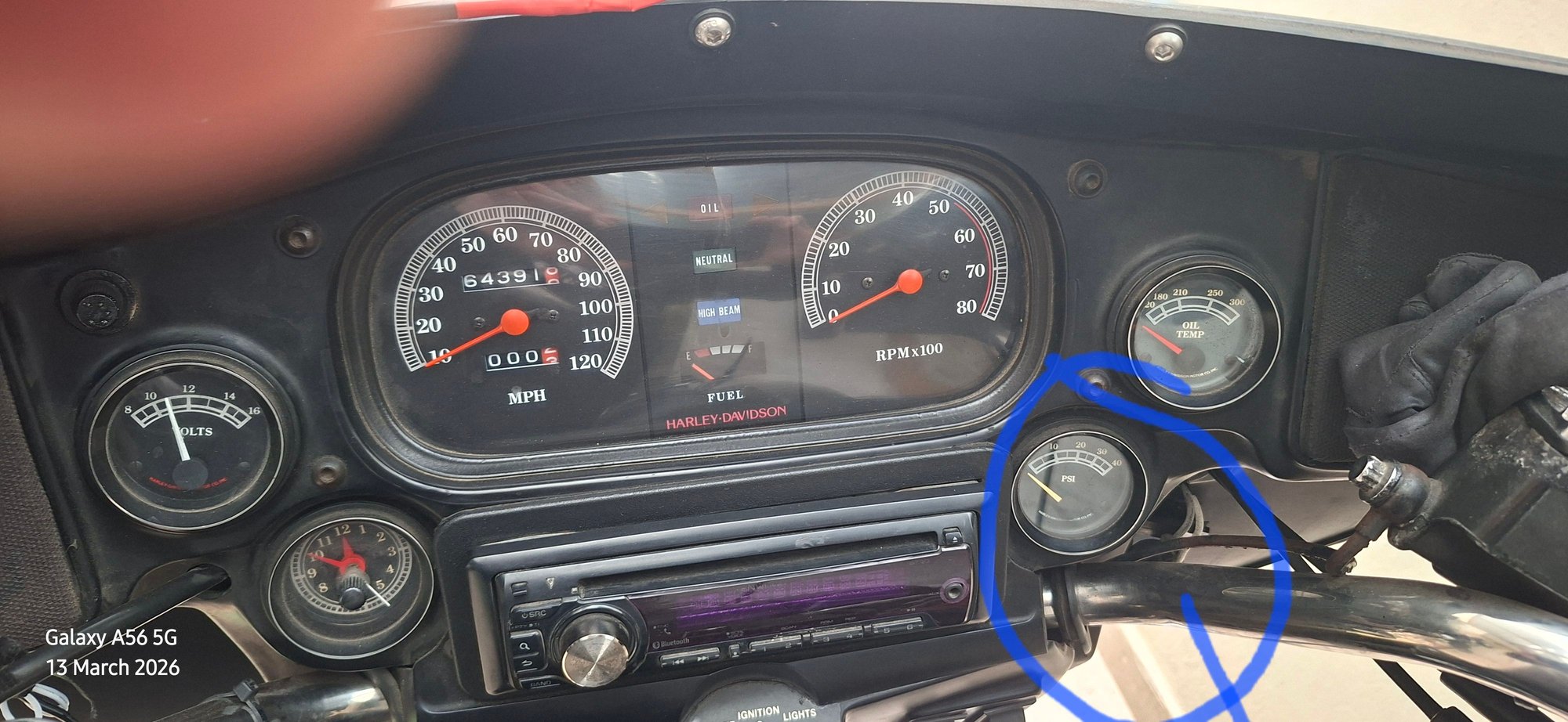

When I driving at 2500 r.p.m must pressure gauge show me 15 psi are this o.k ? If doesn't what's wrong?

Tee in a direct reading gauge to determine if it’s an indication issue or a real pressure issue. Your English is fine.

As @jbarr1 said, you can use a mechanical gauge to determine the actual pressure, a 38 year old gauge/sender could be very inaccurate.
It may read 0 when it is hot, but as long as you don`t hear the lifters clattering (loudly) you have sufficient oil pressure.
