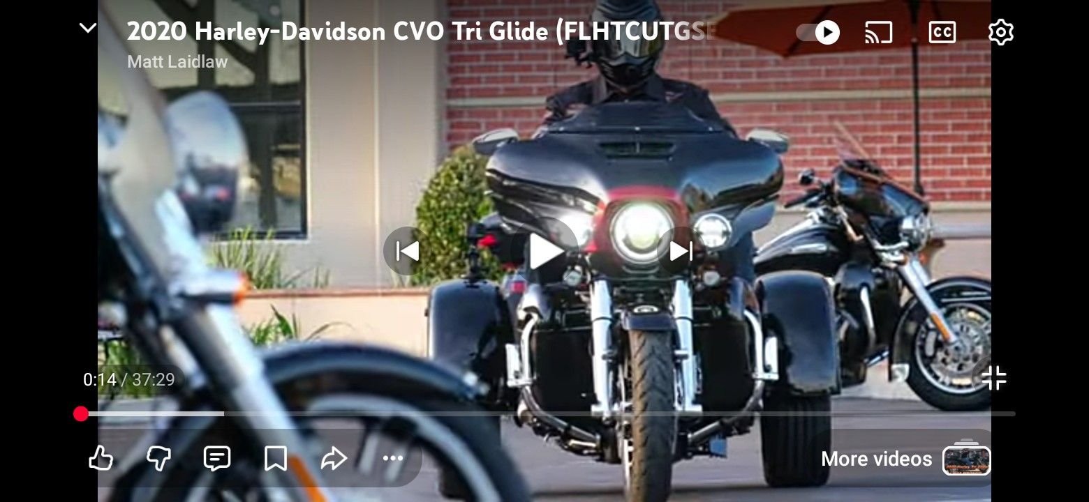

It's the photosrobic effect. Not visible to the naked eye. Video captures images @ 30 frames per second which is faster than the human eye can detect.
Below are some screenshots from a video that illustrate the photosrobic effect. At the 13 second mark, the left signal appears on while the right signal appears off.
At the 14 second mark both signals appear off.
At the 15 second mark, the right signal appears on while the left signal appears off.
She insists she sees the flashing. But we’ll check again later today

We went back out on the driveway. No phone this time. It was the photostrobic affect. Mystery solved. Thank you all, especially barneyboy, for your replies. I was fixn to start taking it apart. Have a great day!!
