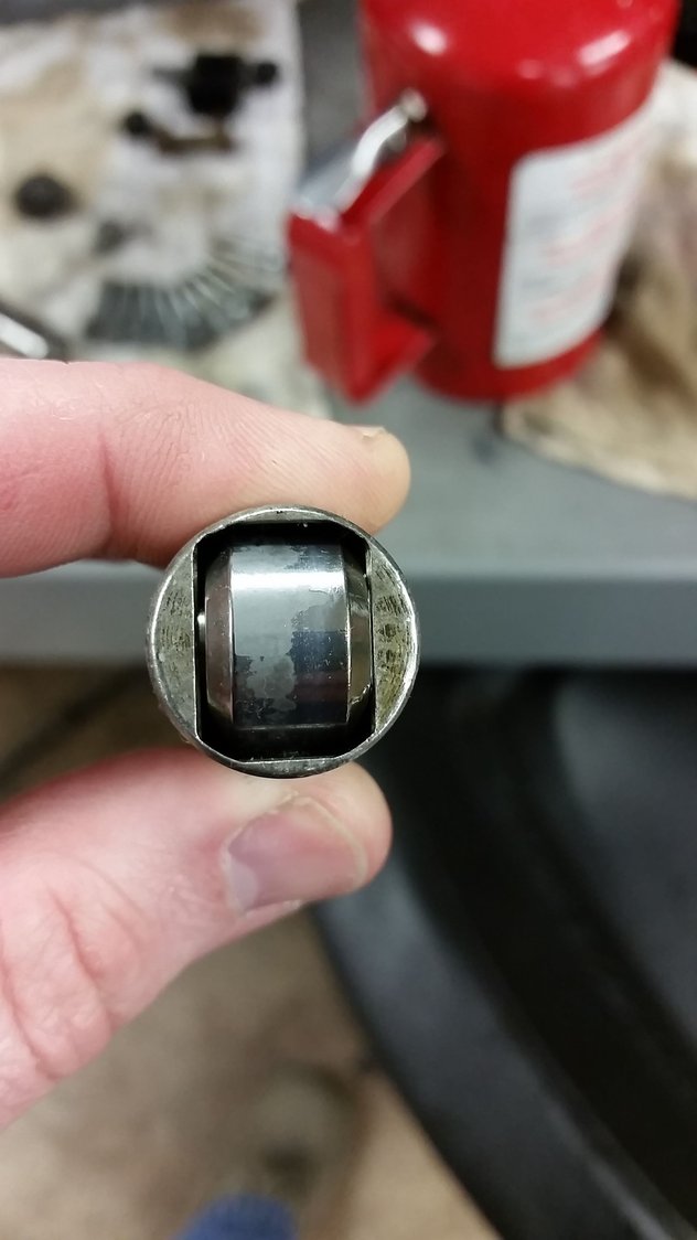

Stock HD lifters less than 15000 miles on the 96" stock motor.
This is what was found during my cam install, seems extreme for a stock 96" with less than 15000mi on it? After seeing this I started doing more research and ultimately found 100's of posts and forums of horror stories about one thing or the other and just as many with 50000mi motors that have never been opened and still going strong.
