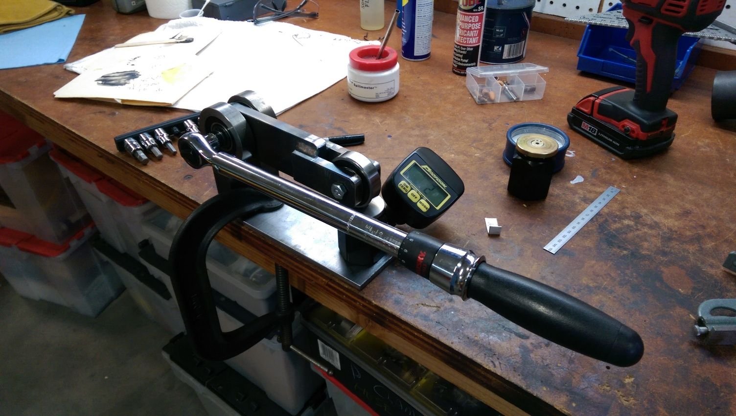

I believe the some dial torque wrenches use a beam inside to feed back the torque value to the dial. They are typically good to 2%.. Typically the click type is only good to 4%.
use what you want,i know mine are dead nuts (i get mine calibrated every year)

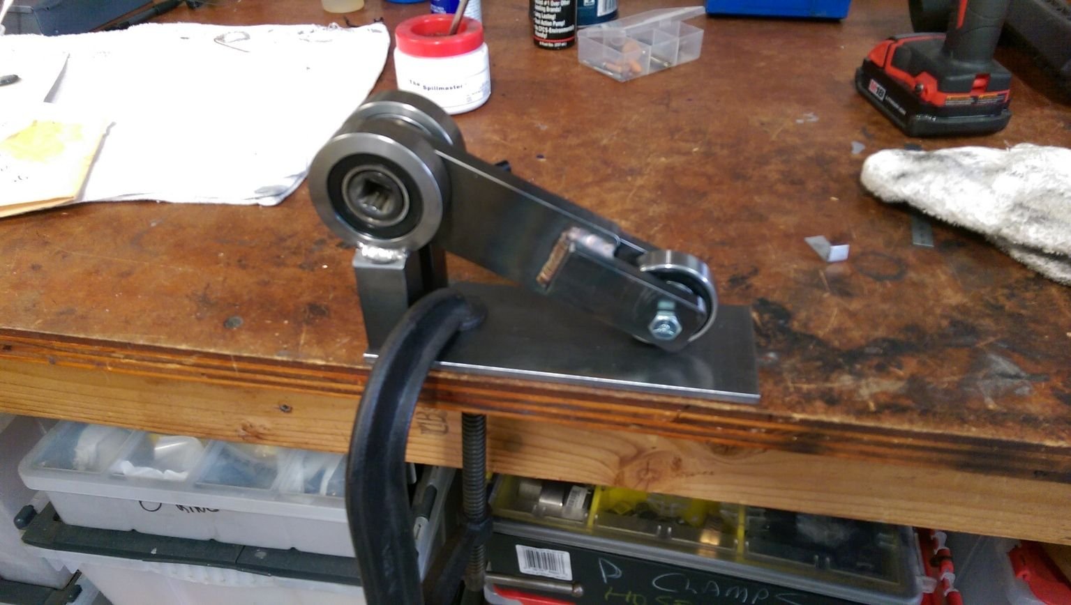

Posts: 19,703
Likes: 7,887
From: poway
Well I built a tester that uses a digital valve spring tester. Tested all the TQ wrenches and they all read within a couple percent of each other. I use click type because I'm lazy but they tend to vary a little measurement to measurement on the same wrench. The deflecting beam was right on and more consistent.
pretty neat little gadget,ill still stick with my click type t wrenches
