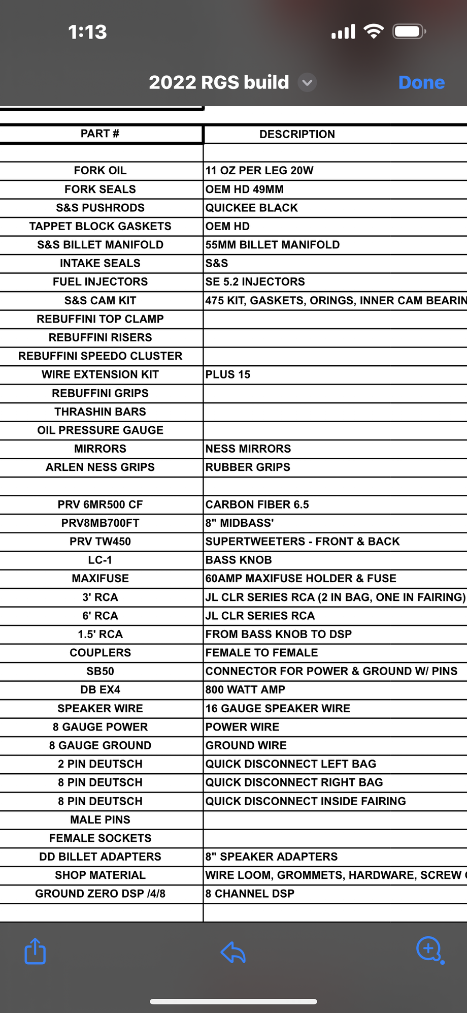

I’ll let the tuner dial the AFRs in. The invoice below was work that was done by Dave Dupor. He did cam and injectors. Cam SS475 injectors 5.2
The previous owner did quit a bit to the bike. Dave Dupor custom builder out of Chicago did stereo accessory’s suspension. Then Dave sends all his stuff to J&B cycles in Wisconsin for dyno tuning and bigger builds.
the bike is going back to Jake at J&B for top end and I’m considering doing the crank. Then when Jake is done going back to Dave for 6 more speakers and 2k more watts of stereo. Along with some lighting and I’m adding dirty bird lowers.

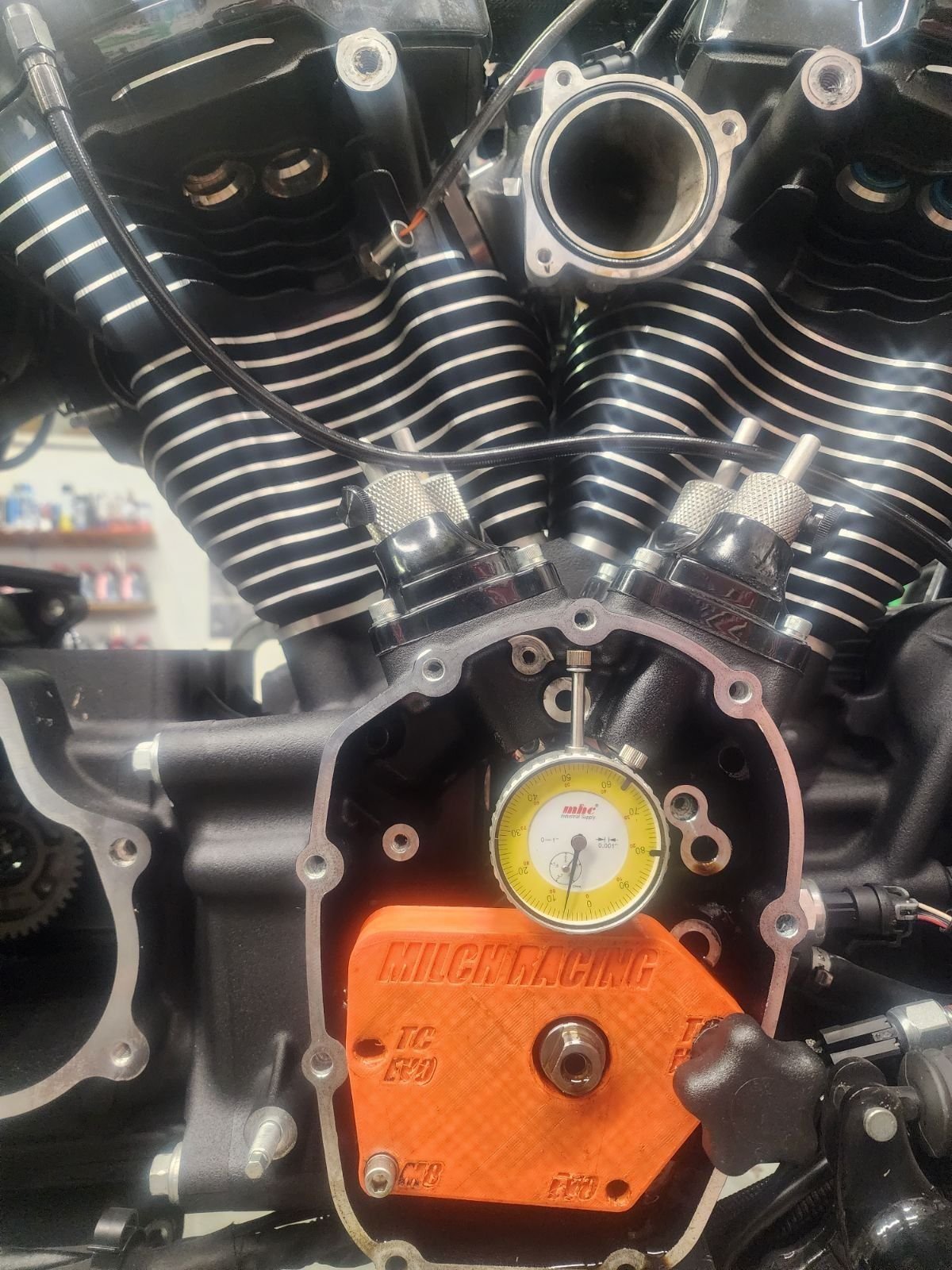

This is what I'm talking about with your 131"

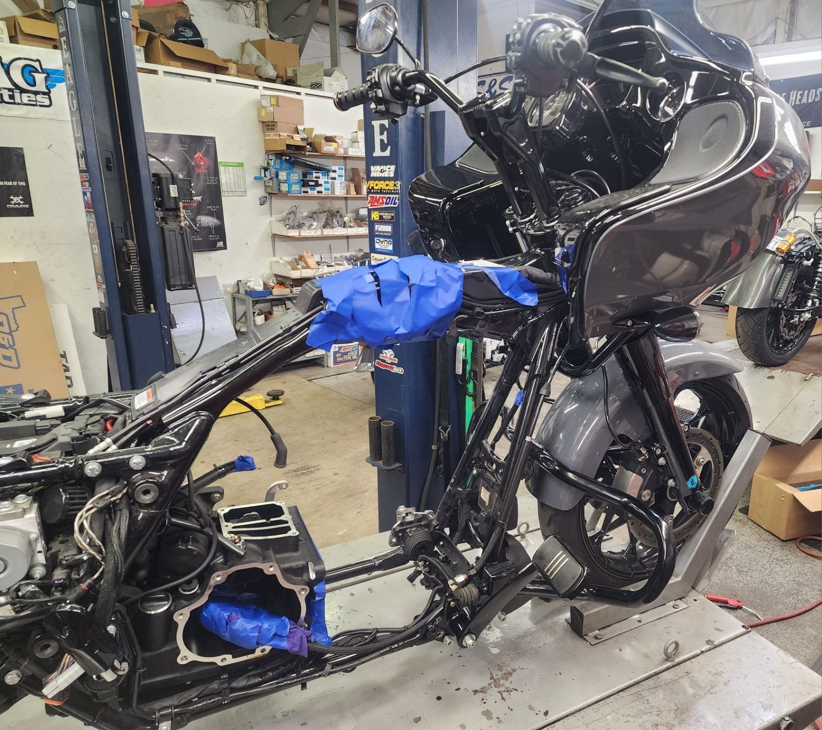

Update on build

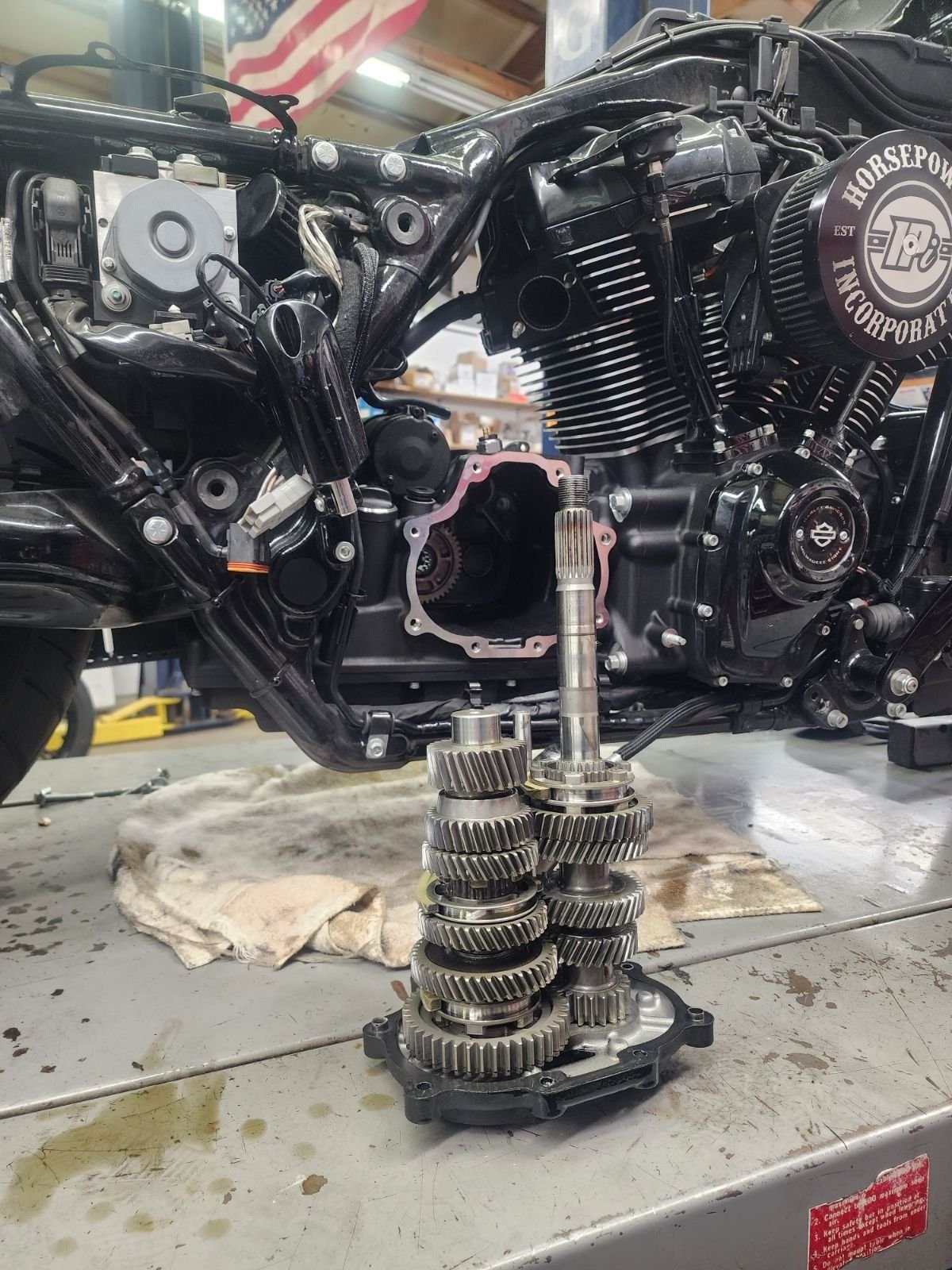

crank was .0065 out so pulled it S&S going in. The longer stroke will make it a 133. I also had the transmission pulled it’s going to Andy Simonso he can do his magic new trap door and shift drum.
I went with evolution clutch.
cry once I guess.
Still undecided if I just go to chain drive.
Also torn on if I should go gear drive or just leave good enough alone.
Goal is 170ish HP & Torque 🤷‍♂️👀

Ive talked with a few trans guys and done quit a bit of reading on the baker. To many guys blowing them up multiple times. Its not for me.
Here is a video of andy going over what he does and why. These guys no there **** when it comes to the trans.
