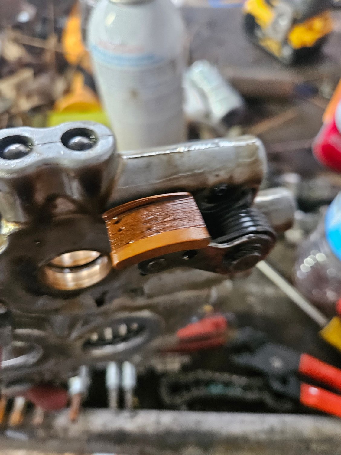

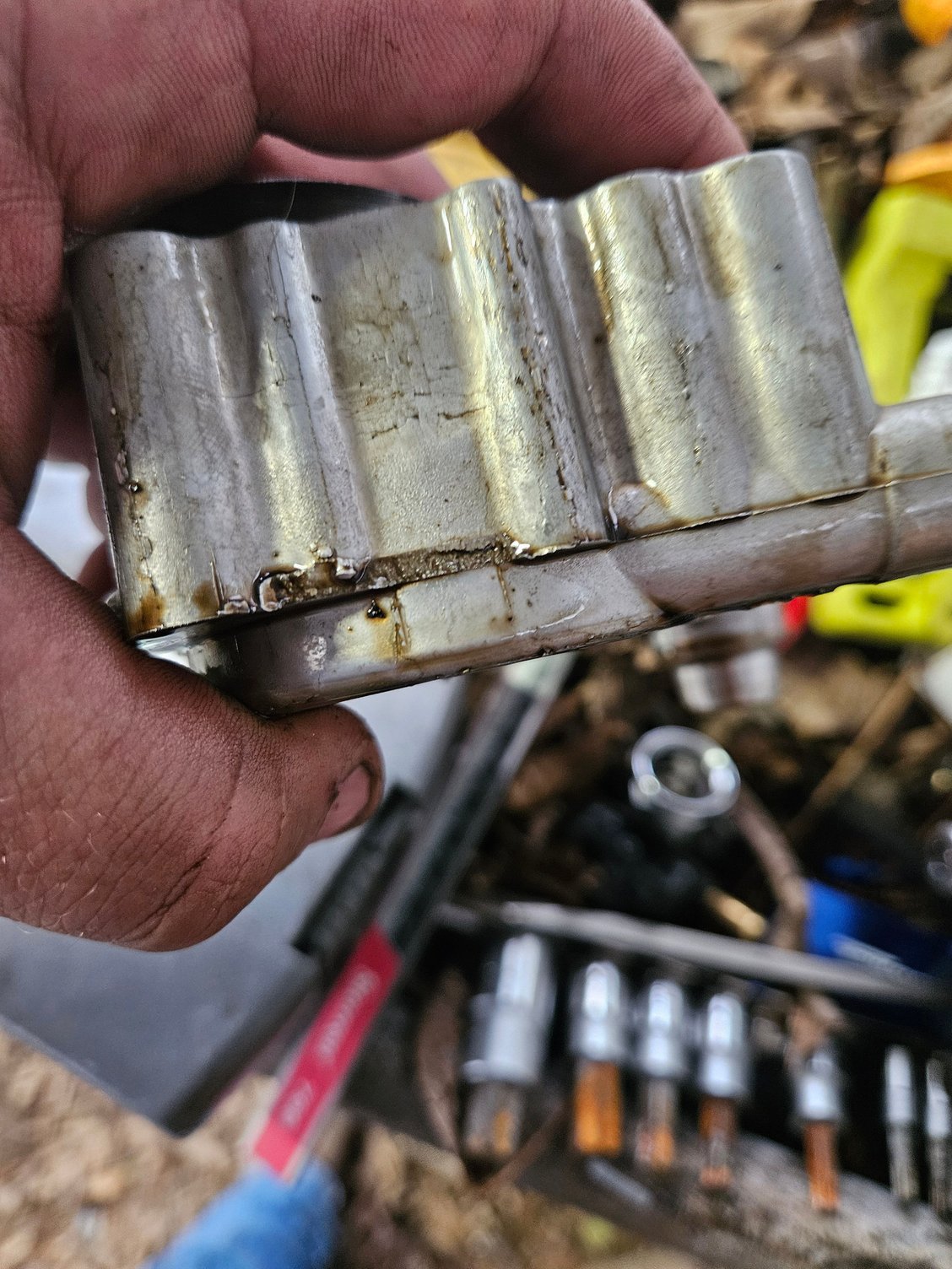

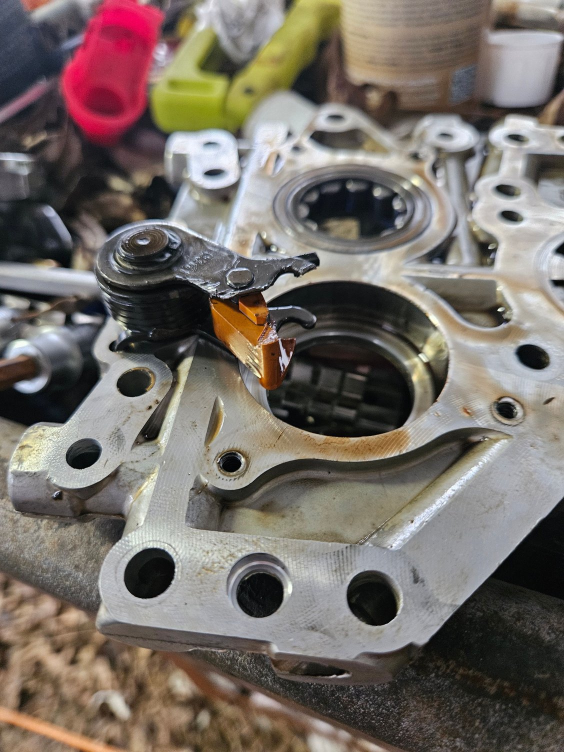

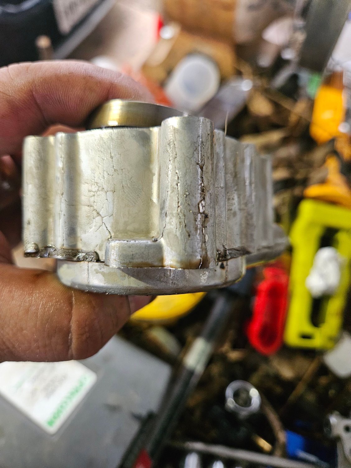

Thanks for the help I believe it is sumping I opened the timing cover and over a quart came out on top of that the cam tensioners are down to metal. Would it be best to replace the pump or new orings.

Maybe on the pump; definitely the tensioners. Google CYCO tensioners; they have proven to last longer than OEM. The cam plate, with cams has to come out and the cams have to come out of the cam plate to replace the tensioners; best practice anyway. This will turn into a larger project because both inner and outer cam bearings should be replaced. Some will suggest upgrading to later hydraulic tensioner and roller chain, and if funds are available, why not but for a basically stock motor, the OEM oil pump, is up to the task. Special tools are required to R/R the inner bearings and the cams and outer bearings may need to be pressed out and back in. Maybe you can find a local independent to do the whole job or at least to the press work required for outer cam bearings and cams. There is a DIY "oven/freezer" work around for that.
A good inspection of the oil pump will tell if it should be replaced; I suspect it might be toast. Look for scoring of the pump and the back of the cam plate. Check the internals, the gerotors, of the oil pump for damage. Crank run out should also be checked while the cam chest is open
You should get your hands on the service manual for your bike if you plan to DIY this project. It is not as difficult as it may sound but if you are not comfortable taking it on. Look for a local independent with a reputation for good work. If you decide to DIY the project, there is lots of help on this forum from guys smarter than me.
Of course, all new o-rings and parts can be ordered from your local dealer of from an online discount dealer like Newcastle or Surdyke. You can Google Ronnies HD for illustrations to identify the parts and part numbers you will need.

I belive the pump is the culprit due to all the cracks on it got the tensioner and pump on its way now I would have never guessed it was that. But I did find out it has seh 203 cams in it. I bought the bike years ago with only 30k on it. So that's a plus.
