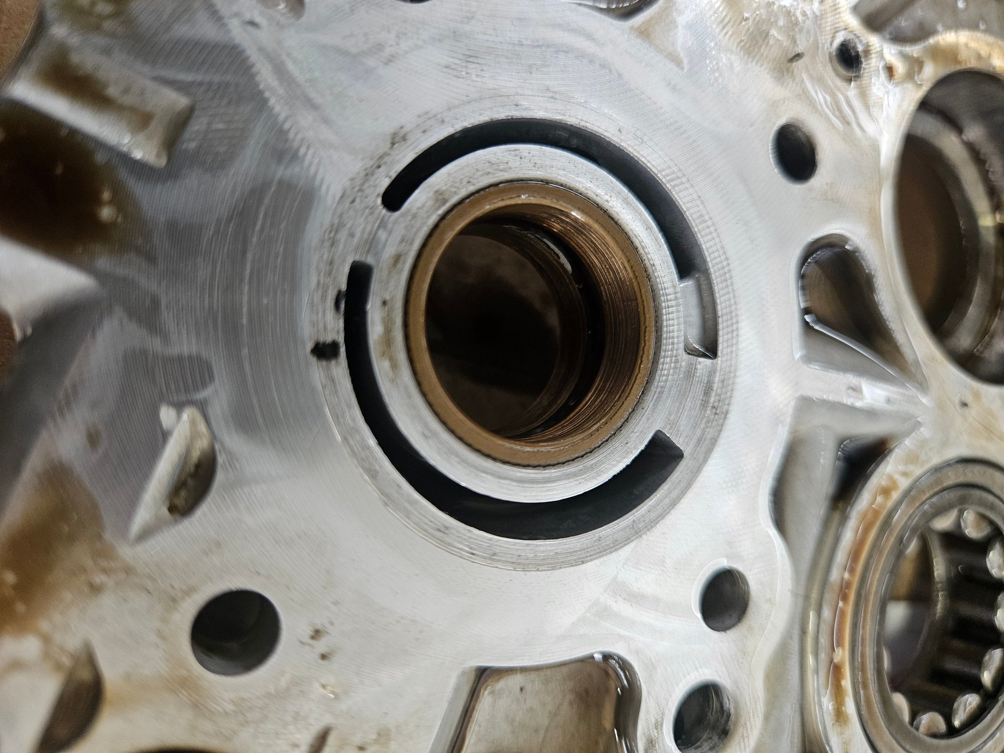

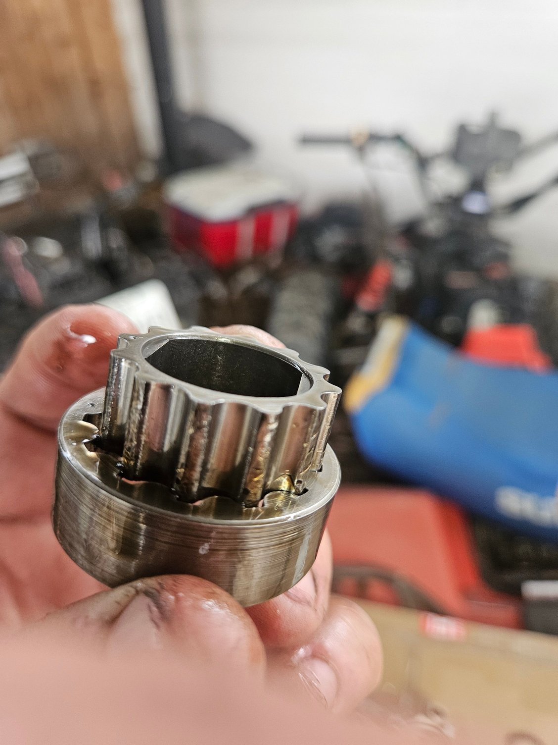

Due to all the scoring and the internal gerotors stuck together and the teeth smashed I'm sure the culprit is the pump. Is there supposed to be a gasket between the cam plate and pump. When I pulled it apart there was not one.

Old Feb 9, 2024 | 01:32 PM
Ohio HD's Avatar
Ohio HD
Joined: Mar 2012
Posts: 986
Likes: 948
No gasket.

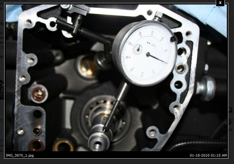

Time to measure the crank runout.

Old Feb 9, 2024 | 02:06 PM
djl's Avatar
djl
Joined: Jun 2006
Posts: 12,763
Likes: 2,597
From: san antonio
Crank runout measurement was suggested back in post #6. Maybe to OP doesn't have the tools to check; several ways to do it and a picture of one way is attached. I am thinking the oil pump at the metal bits from the phuked up tensioner.:icon:shrug:

Old Feb 9, 2024 | 02:14 PM
Ohio HD's Avatar
Ohio HD
Joined: Mar 2012
Posts: 986
Likes: 948
Originally Posted by lemay123
Run out showed only 1 tho out.
That's amazing for a stock HD crank. Although it is the earlier crank.

Old Feb 9, 2024 | 05:56 PM
djl's Avatar
djl
Joined: Jun 2006
Posts: 12,763
Likes: 2,597
From: san antonio
That's good news. I believe the pump ate the metal bits from the phuked up tensioner and destroyed the oil pump. BTW, the Daytona pump has increased capacities on scavenge and feed sides. Keep us posted on the repair.

Old Feb 9, 2024 | 11:15 PM
60Gunner's Avatar
60Gunner
Joined: Sep 2017
Posts: 4,359
Likes: 1,219
From: Dubuque, IA
Originally Posted by djl
Need more pictures; internal pump cavity where the gerotors ride, gerotors and back side of cam plate where the pump rides.
Definitely debri run thru that pump. Cut the filter open and have a look see. But I'd be more worried about what isn't there and where it went.
Get yourself a FSM. You're about to get a crash course in engine disassembly/assembly.
Good luck...
