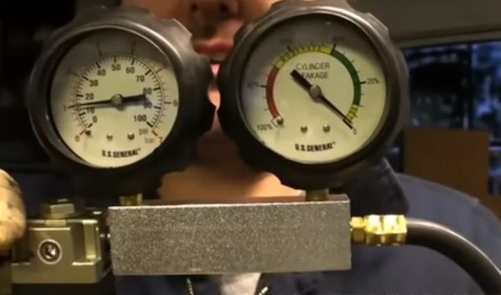

Cool. Where did you get that 90 psi. I have my compressor 125 since I have a 3/4 impact on used on compensator and Honda damper bolt.
However, when I calibrate the leak down gage set, I don't remember seeing 90 on it. More like 15 like this attachment being calibrated.
What kind of leak down set are you using?
However, I don't have access to it since we are still far south.
