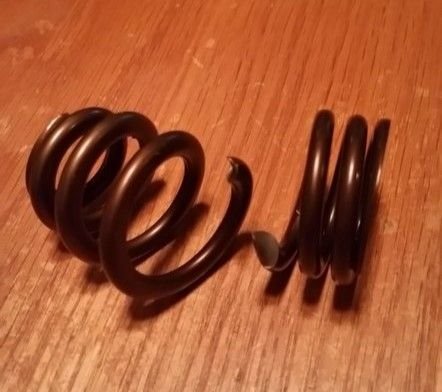

Had them put AV&V in my 2012 CVO 110....
This happened a few thousand miles later.
I'd look elsewhere...
I have been in contact with RedShift and they strongly advice against using beehive springs with the RS587 camshaft because this camshafts are designed to work with the stock springs. I will now change to the stock springs.

It's rare for the Beehive spring to break. I've installed thousands of them.
If they told me that I'd be looking for a different cam.
