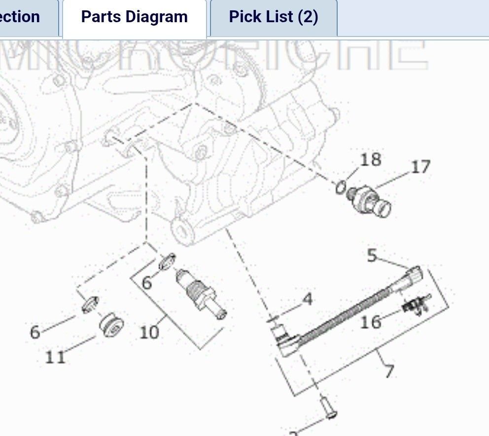

oil light was on and no oil pressure so i changed oil pressure switch and added oil,oil light went off but still says no oil pressure. Will it hurt my bike to ride it?

Do not drive it. Only start it briefly. Do not start or run it if you hear the lifters clicking and clicking in the top of engine.
My guess and only a guess is the new switch doesn't have same calibration and it's just showing maybe OK or maybe not. Even correct for it, it could only be a few pounds to cut off light.
Obviously you have a bike with a display reading. Not sure where it gets reading. AI says it has one just for the PSI reading. On a car, some have only one switch but it has more than 2 wires coming from it.
I would either trailer it in, or put a mechanical pressure gage in to see what's going on.
Was it low on oil? What procedure did you use to check it? Did you hear any clicking or other new noises?

Know no noise and my engine light was on so I checked my oil yes little low so I added bout half a quart of oil and changed oil pressure switch light went off still no pressure. The switch is a aftermarket switch, should I pull it and order one from the Harley shop??

I would get a mechanical oil pressure gauge to verify actual oil pressure then go from there.
tommyt2112. @tommyt2112
You have been ask twice now for your model and year Harley.
I see only one pressure sensor even on the late model Harley with an information dash screen.
Remember what I said in my first post, don't drive it like that.
Yes, get a OEM sending unit. While there, ask for the one that controls the one that is giving you the read out in PSI and see what they say.

Disconnect the wire from the pressure sensor and see if the oil light goes out..
