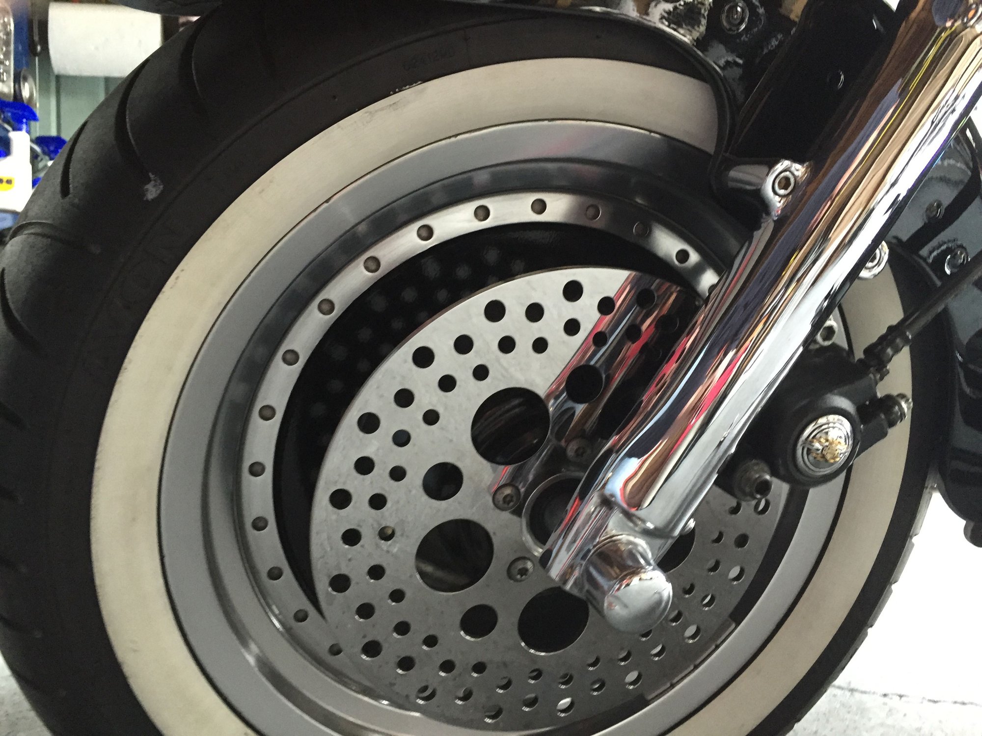

1. The shifter spline seems loose in the housing, allowing it to pivot up and down perpendicular to the bike. The service manual doesn't have anything about how to assemble it, but I found an explosion diagram on the internet. I got replacement parts from an online harley parts store, but they were supposed to be x2, but they were x1.
2. The brakes seem really weak. I don't know if it's just evo brakes or they need work. I bought some shoes and pads and will research how to replace the fluid.
3. Need to replace primary and transmission fluid.
You might try a better lever http://betterlever.com/
It is EVO brakes (inherently weak).
The front is easy as gravity will drain it for you the rear I use a vacuum pump I got at Harbor freight for $20 (it makes it a lot easier).
I got a drain tray from Harley that is big enough to catch all the fluid when opening the primary (think bigger than a turkey baster tray)

Put on jack or have someone sit on it and hold it up...remove stop on top of stand...swing stand around...put spring on...swing back and reinstall stop...saves blood sometimes.
As suggested a vacuum pump to get all the old brake fluid out. Clean, clean and clean the reservoirs out them fill with some new DOT-5. Use the vacuum pump to move the new fluid through the system a bit, then make one more manual brake bleed keep the fluid in the reservoir. Works very well. Just re-did both front and back brakes including new pads and rotors. The old front rotor was warped a bit. I've heard new brake lines will help also, but for my riding, the brakes work very well.
