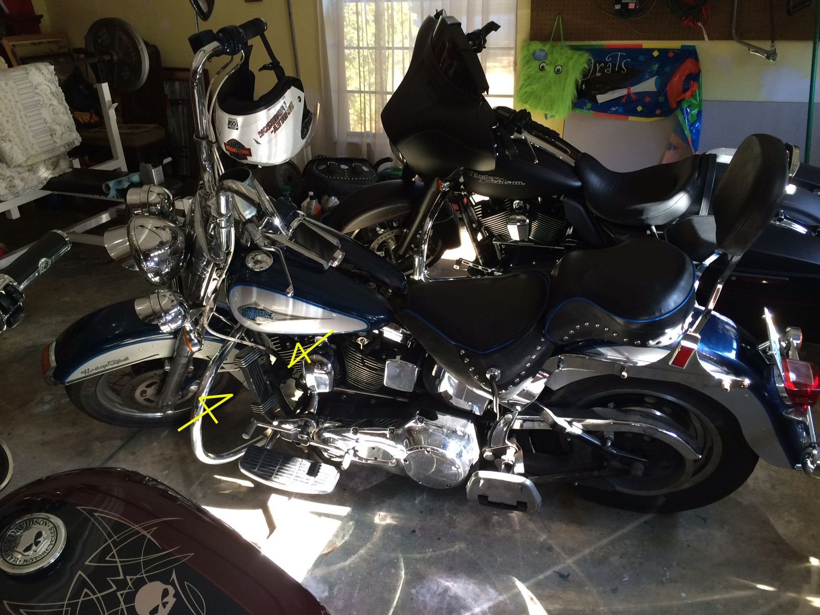

Thanks everyone for the tips. Had to take a break because of Turkey Day, but plan on getting some fluids tomorrow. My biggest concerns are the shifting from 1st to 2nd and the brakes. I plan on putting MOBIL 1 syn dextron trans fluid into the transmission and adjust the clutch for #1 (got the tip on here), then shoes, pads, fluids for #2. If I can get both of those fixed, she's safe enough to ride.
BTW, WTF is this?
Old Nov 29, 2014 | 02:17 AM
Rhino-1's Avatar
Rhino-1
Posts: 717
Likes: 15
From: San Dimas
Oil cooler...
Old Nov 29, 2014 | 06:25 AM
texashillcountry's Avatar
texashillcountry
Dirt don't hurt
Posts: 21,062
Likes: 4,547
From: Haslet Texas
It looks like a Jagg 6 core oil cooler.
Old Nov 29, 2014 | 11:12 AM
Dan89FLSTC's Avatar
Dan89FLSTC
Active Streak: 30 Days
Joined: May 2008
Posts: 21,032
Likes: 12,559
From: South Carolina
Originally Posted by Clubber
BTW, WTF is this?
An unnecessary (and ugly) part on an Evo. You don`t need an oil cooler for an Evo engine.
Shifting problem: get out the service manual and perform a shifter pawl adjustment, and a clutch and clutch cable adjustment.
