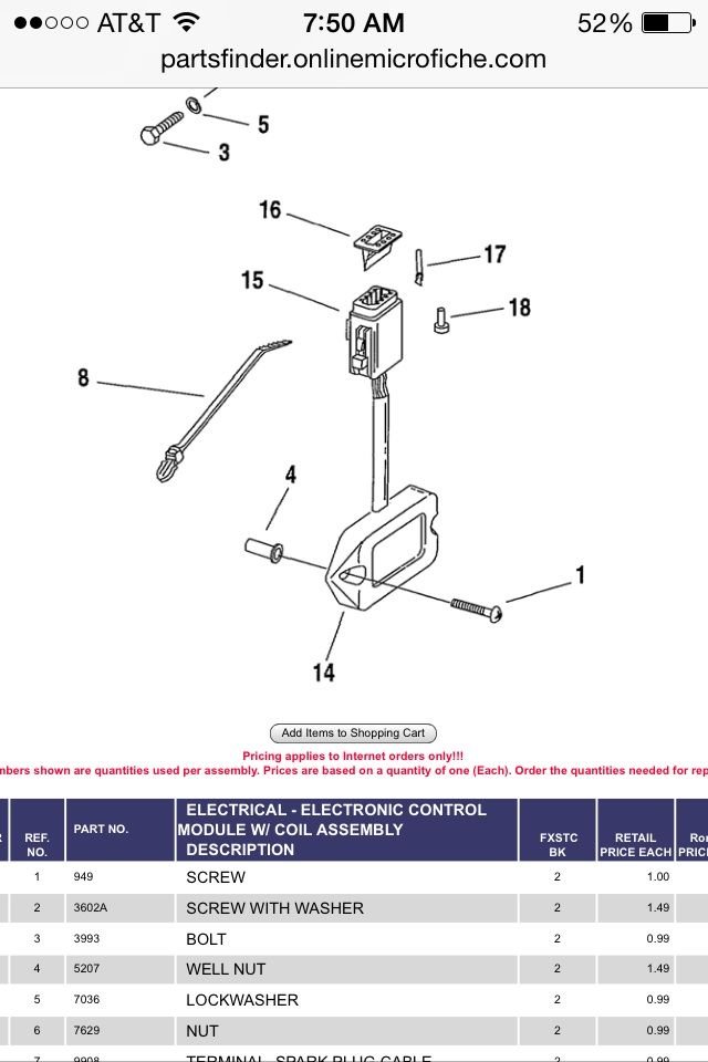

There are well nuts for the mounting screws, if you can get behind the module and grab the well nut with a pliers or drill the heads off and maybe push them through.
The two replacement screws and well nuts cost about $5
