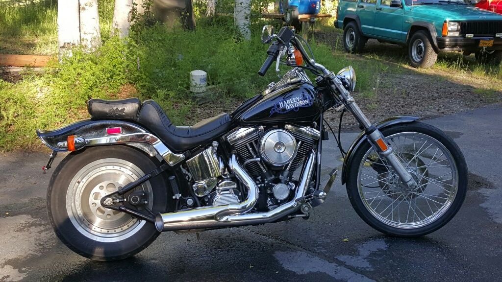

I just put a new 2 into 1 exhaust on my 89 FXSTC. The pipes I replaced were basically drag pipes with fake mufflers. When I pulled the old pipes, I found the po had installed torque cones which I left out of the new install.
The New exhaust looks good, sounds good, and I'm consistently getting 53 mpg.
I believe the bike has the original carburetor, What should I look for that would suggest re-jetting>

Why do you think it needs to be rejetted? How does it run now, any worse than before with the old pipes? How's the throttle responce? Are the spark plugs hot looking or sooting up? I'd just ride it and feel her out, look at the plugs after a long ride.

I don't think it does need to re-jetting but since I completely changed the emission system, I thought it prudent to ask what possible telltale signs to look for.
Also, the instructions that came with the new exhaust said I may need to re-jet.
