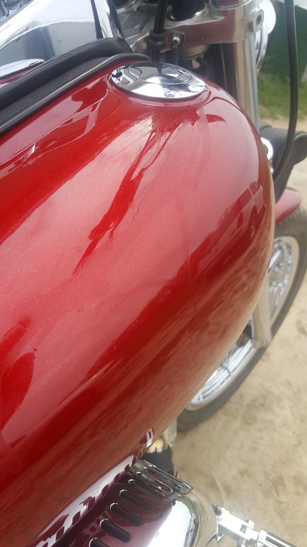

Well I bought a set of flush mount gas caps, love the look....hate the gas all over my bik. Looking at getting the bikers choice 0120156, but can't find a picture of how flush they mount. So does anyone have pictures of what they used and if it works good. Back to the big ugly ones for now lol.

It comes right out the middle while you drive. They pop up in the center to remove them. Clearly no seal on the inside, just the outer gasket. Started with k I can't recall the brand already tossed the box.

I had one of those pop ups on a fatboy, I had to take the cap (the pop up) and sand the bottom down some on a flat piece of sandpaper. That took care of it. It was a hair to long.
