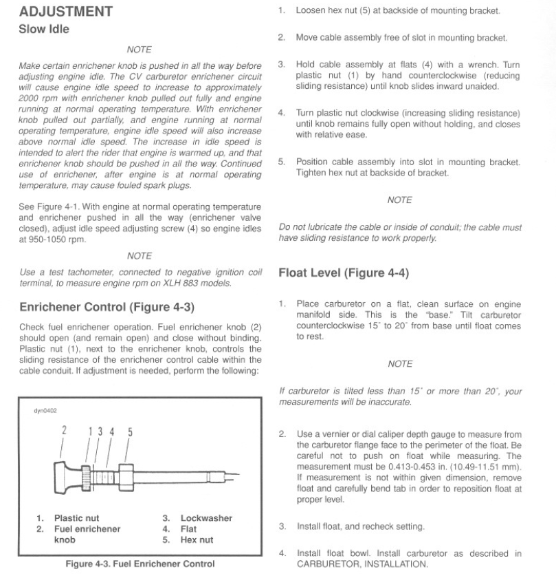

This is from the 1998 Sporty manual but the choke operation & cable adjustment is the same for your bike.
A clothes pin works good to hold the choke out.

Remember, do not lube this .
