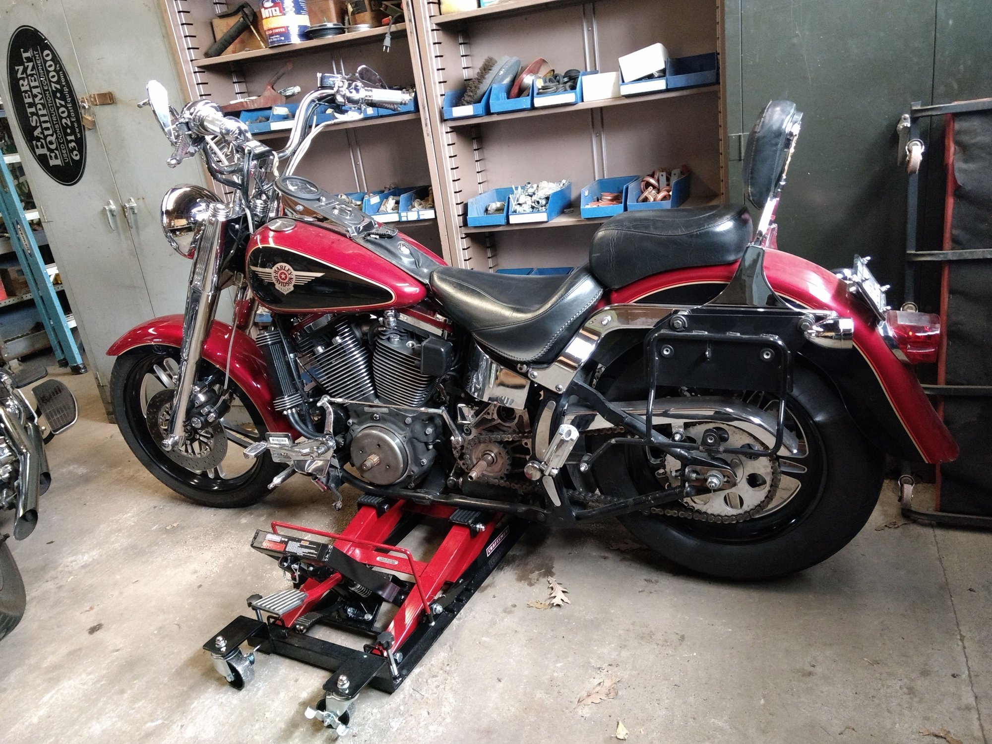

So for the last couple of months I started to purchase pretty much everything I need to hopefully finish out everything I've ever wanted for my 98 Fatboy. Thanx to langwilliams the OEM shocks made a huge difference. Thank you brother....
First off, let me tell you it was only 26* today and the garage I have my bikes in does not have heat.. I was out there from 10:30 am to 4:00 pm. Yes I felt it and said just keep moving...
So i wanted to go back to a belt on the secondary and purchased a new S&S 1 1/8" belt on eBay for $157.00 and found a 70 tooth pulley off of a 2006 Dyna $36.00. I also purchased the S&S G and had a ThunderJet installed. I like the idea of 3 jets...
I also need new rotors, the matching ones that came with my rims from Southern motorcycle works went to **** way to quick, Floaters. The centerpieces are made of aluminum and wore out at the rivets allowing the braking disk to rotate 3/32”. They didn't want to help me out so I purchased new 1 piece rotors from Jireh cycles, $68.00 each delivered.
Still working on trying to remedy my problems with my primary drive. It appears there was a mix of old and new parts so I'm still waiting on that.
I also decided to go with a Baker OD6 builders kit with the N1 shift drum. Waiting for a quote from Mark...
last but not least I also installed a new S&S. hvhp oil pump. I had a scavenging issue the last time I had the bike out. The case was filling up with oil and was pushed out at the crank shaft seal. I was idling at a gas station and within a couple of minutes I had a puddle the size baseball. I checked the oil level and it was down 3/4 of a quart. I'm pretty sure it was problem because the next day the oil sumped again back to the case...
So waiting on some parts but will be back together by spring.... Primary removed and sent out for repairs..

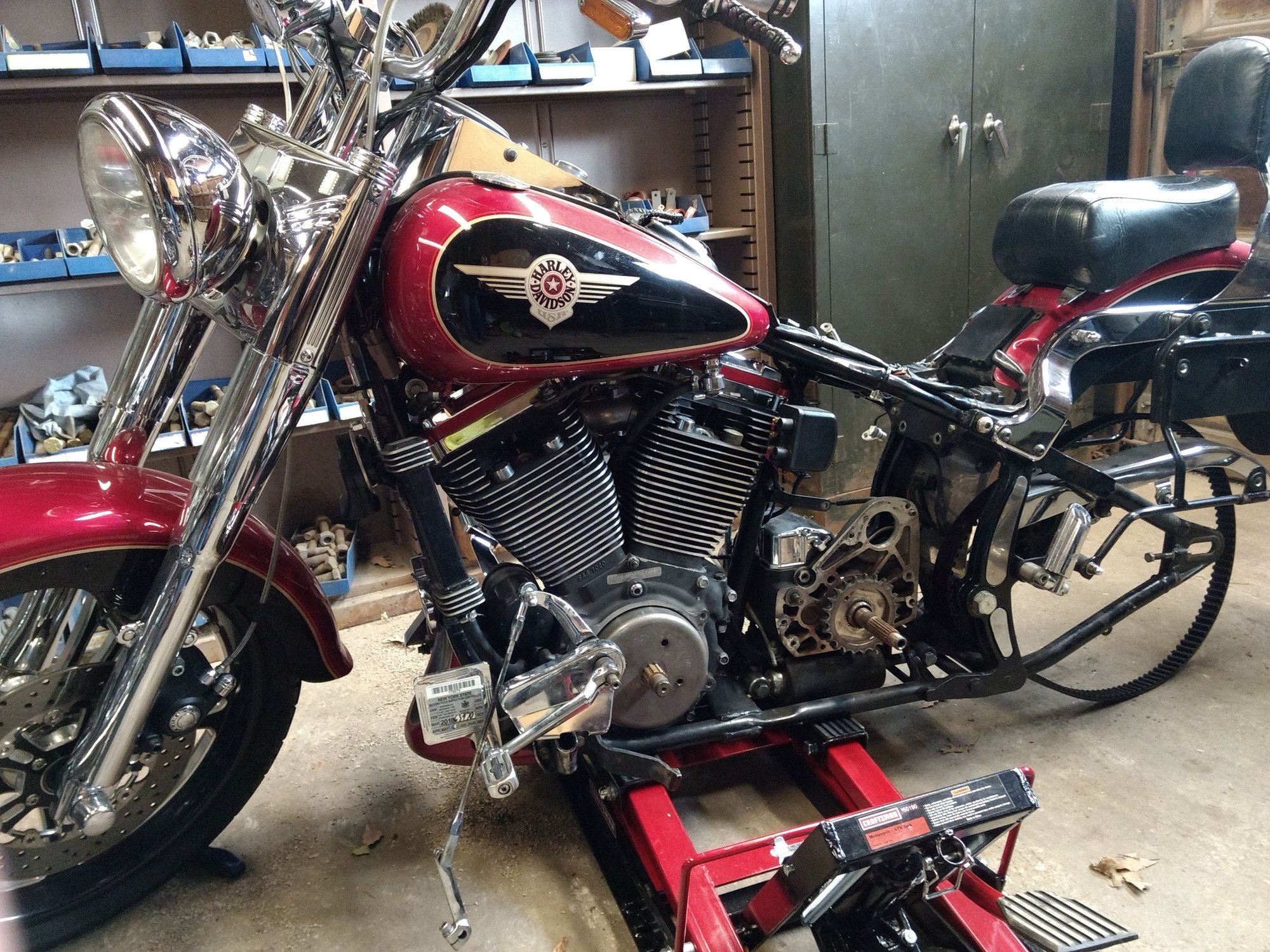

I put the OEM trans back in to check the belt alignment, what I didn't take a pic of was with the rear tire and pulley... Ooopppsss......
By the way I love my new Craftsmen Jack... $109.00... well worth it..
As parts come in I'll update....
That's about it for now.

One thing I thought was a little weird was that I thought the drive belts were directional. Didn't see any marking on the S&S belt except for their part number so I put it on so one can read it normally and not upside down...
When I mocked up the rear tire, pulley and belt to the old trans I did not have the shocks installed and when I lowered the bike I could believe how tight the belt got with the rear suspension up.... Starting to wonder if that's what caused the other 2 belts to brake... Any one ever notice that on their Softail?
