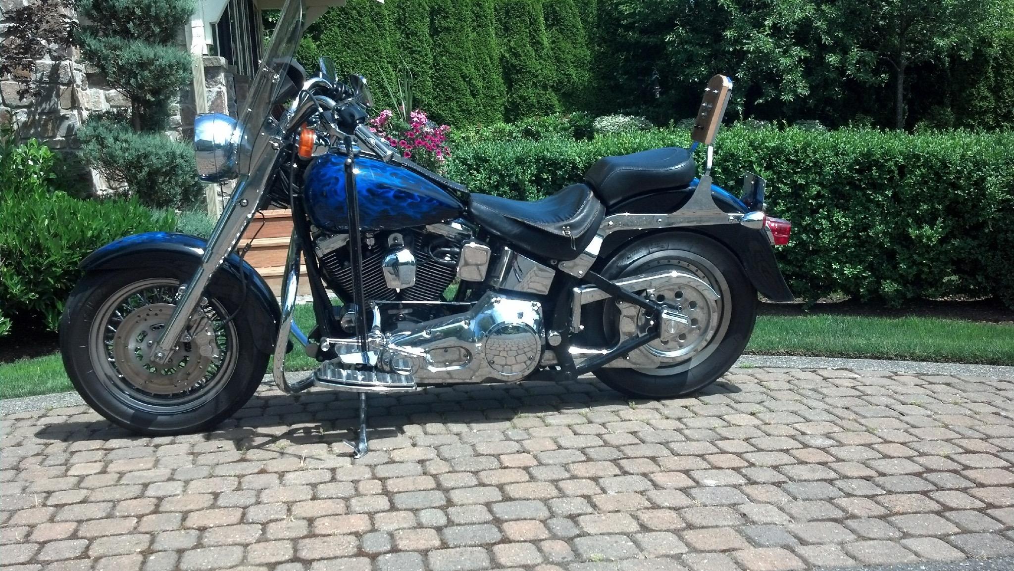

I am really glad I ran across this thread. I just acquired a '96 Fatboy I am trying to freshen up a bit.
I would like to put a set of bigger spoked wheels on it, maybe 18/19 or 16/18 combo? I really don't know what fits on this bike or where to get them from. I assume some sizes are harder for tire selection than others too.
Anyway, thanks for the heads up! Here is a pic of the '96 too.
Keep the rear @16" and do an 18" on the front with a 130-70/18 Metzler.. It'll easily fit under the stock fender.. I even went to a 19 on the front but the widest tire they make is a 120... It's a little thin. The 18 looked better....
