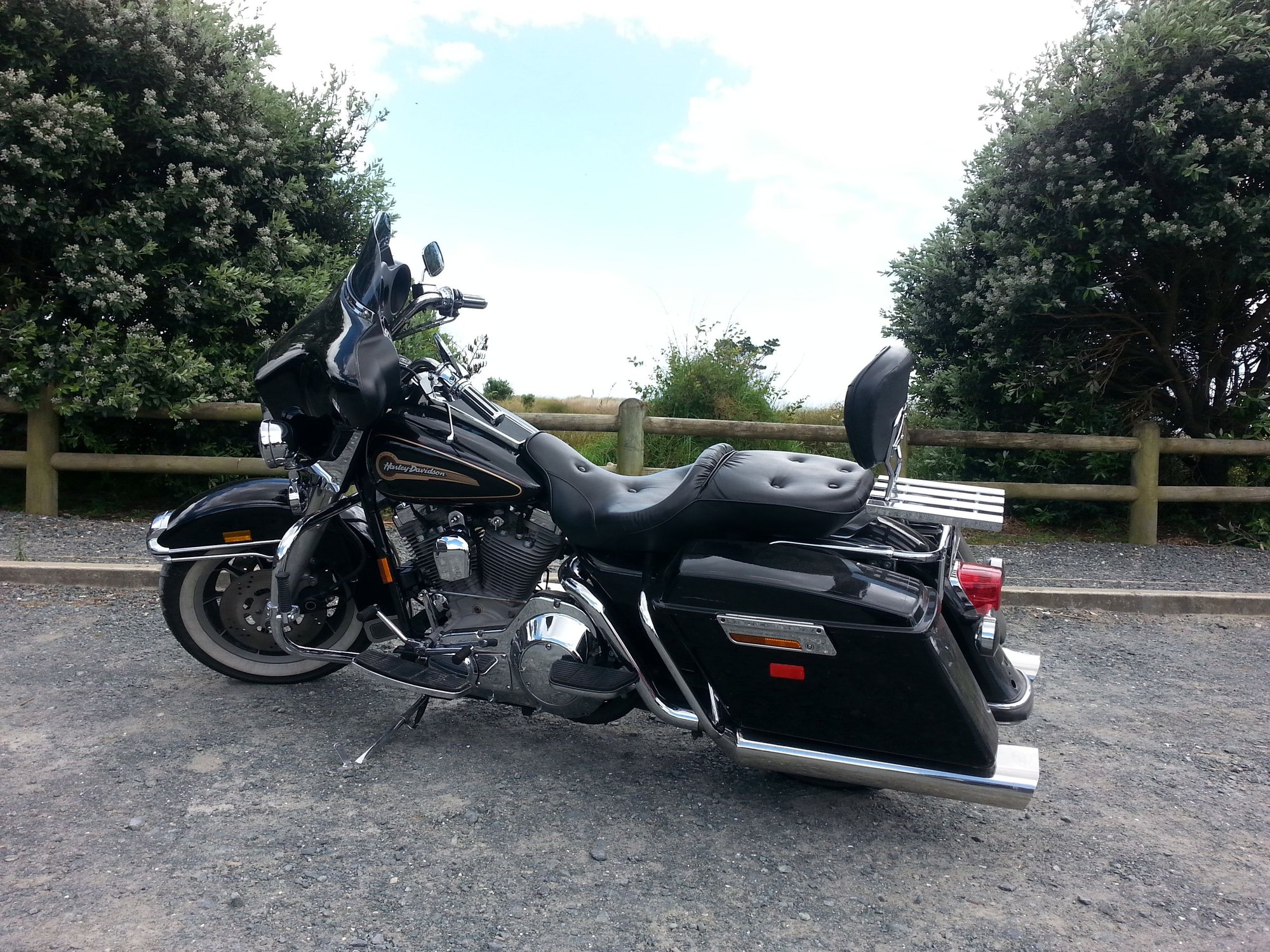

Hey guys long time member but 1st time poster.
A question about earlier se heads.
I have a near stock 97 Electraglide standard. Carbed. Se filter s&s slip ons. Cam bearing and lifters done by previous owner less than 6k on them. Bike has 30kmiles.
I can pick up a set of barely used SE Heads for cheaper than I can get my stock heads ported here in New Zealand.
I know they will bump up compression to 9.5 or thereabouts. Will use a 0.030 head gasket.
I have a Ev27 to go in.
I cant find much info on the heads.
Question is i take it I'll need to use adjustable pushrods as they are shaved from SE to bump up compression?.
