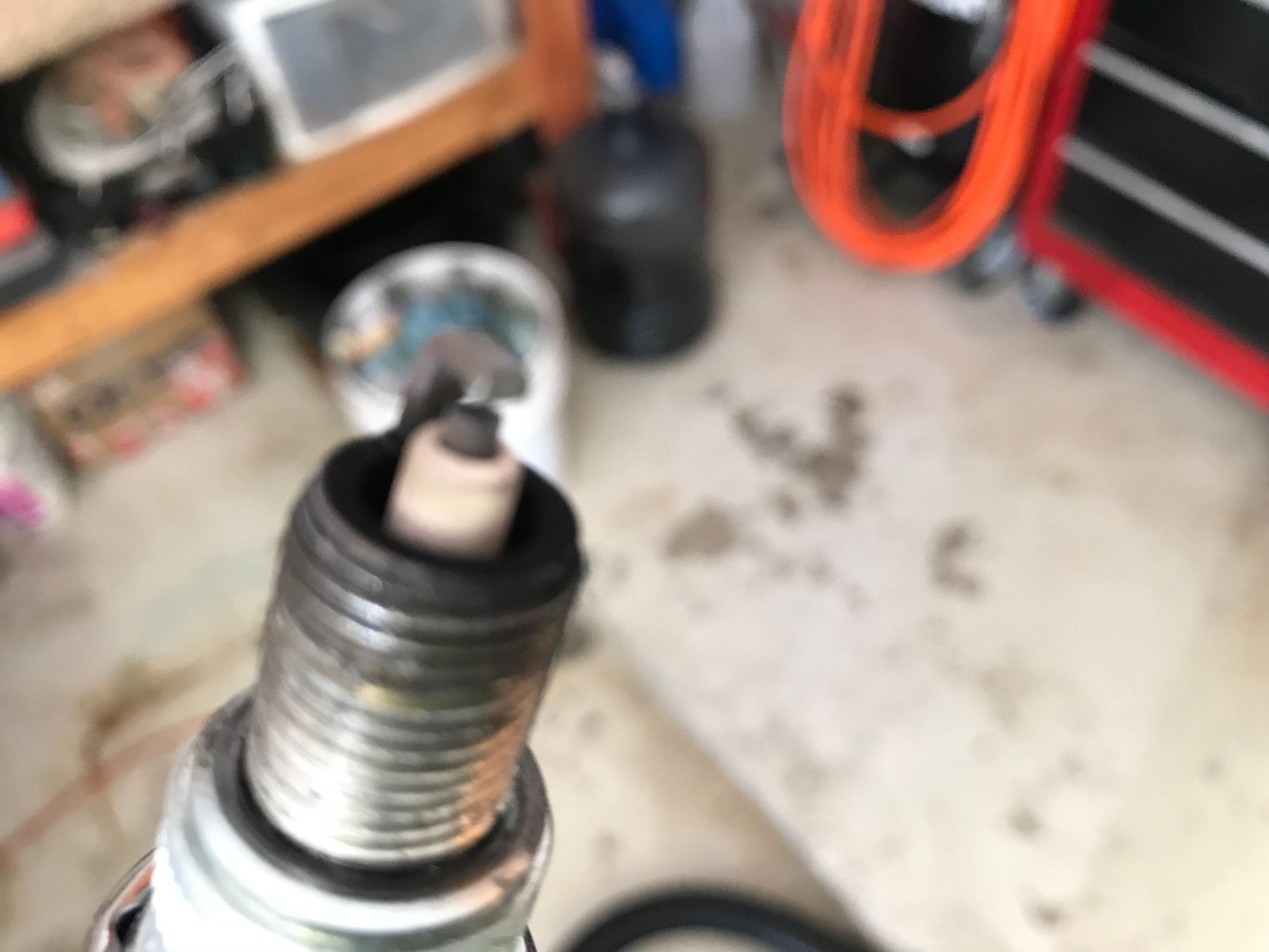

1997 Fatboy Evo.
Mikuni 42
20 pilot
165 Main
98 needle 2nd notch from top
Air screw 1.5 turns out.
Attached pic of plug.
lean?

Originally Posted by Fblo1690
lean?
No. How does the engine perform?
engine performs well. No popping.
