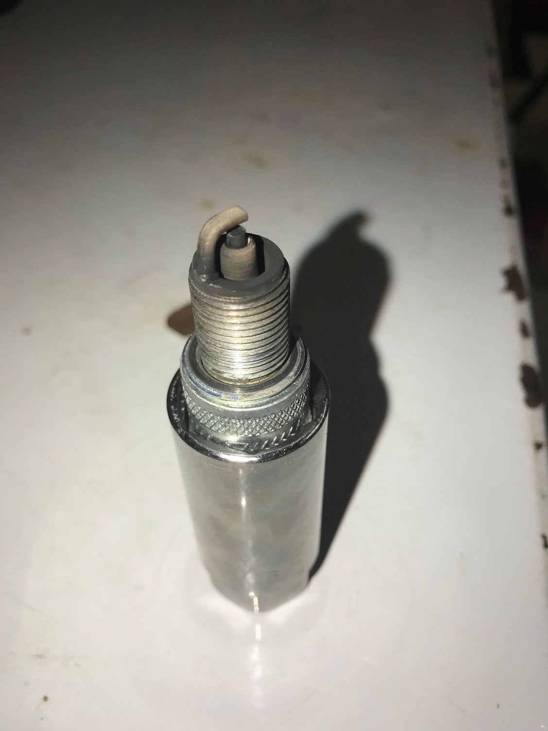

Joe Minton kit works, ran it for several years, I also tune with a AFR wide band reader, it works too. The Mikuni tuning manual is a good one, owners can become familiar with tuning with it.
It is really hard to read by a plug now a days with color except pig rich readings, plug does look lean but conflicting because a Mikuni is known to be rich out of the box to cover a wide variety of engines but fuel mileage is weak and the reason Joe M who wrote the tuning manual for Mikuni created the mileage kit. Anytime it pops out the intake is a lean condition, lean can also pop out the exhaust on de-accelleration, rich can lag when rolling on the throttle.

This is with the stock Mikuni 42 setup.
Is that at an idle?
Or a full load shut dwn?

Idle for a few seconds after a ride. Didn’t have a chance to do a full load shutdown. When I have my days off in a couple days I’ll get to that. Just trying to get the most out of what I have. Not really worried about big numbers, just want efficient.
