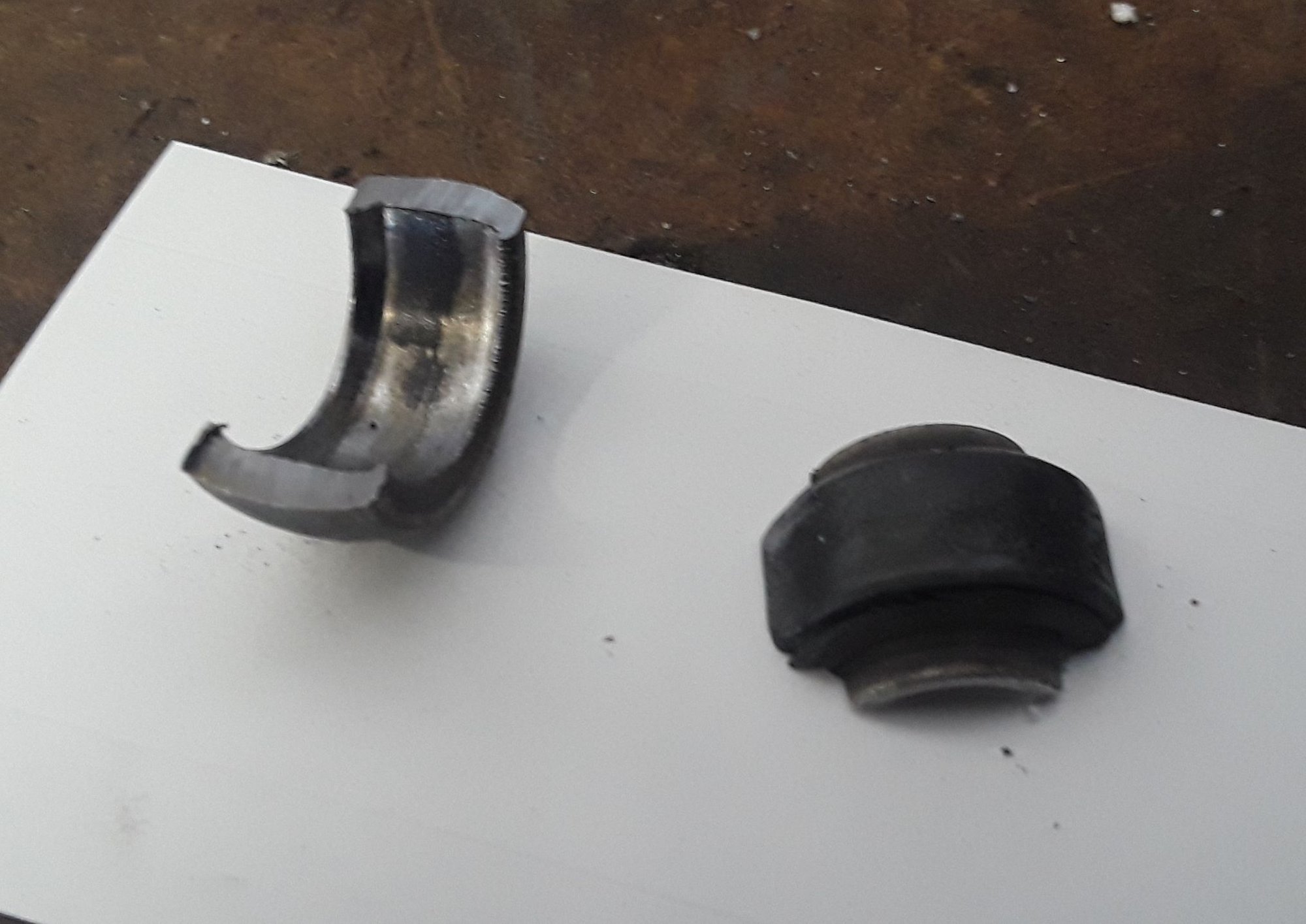

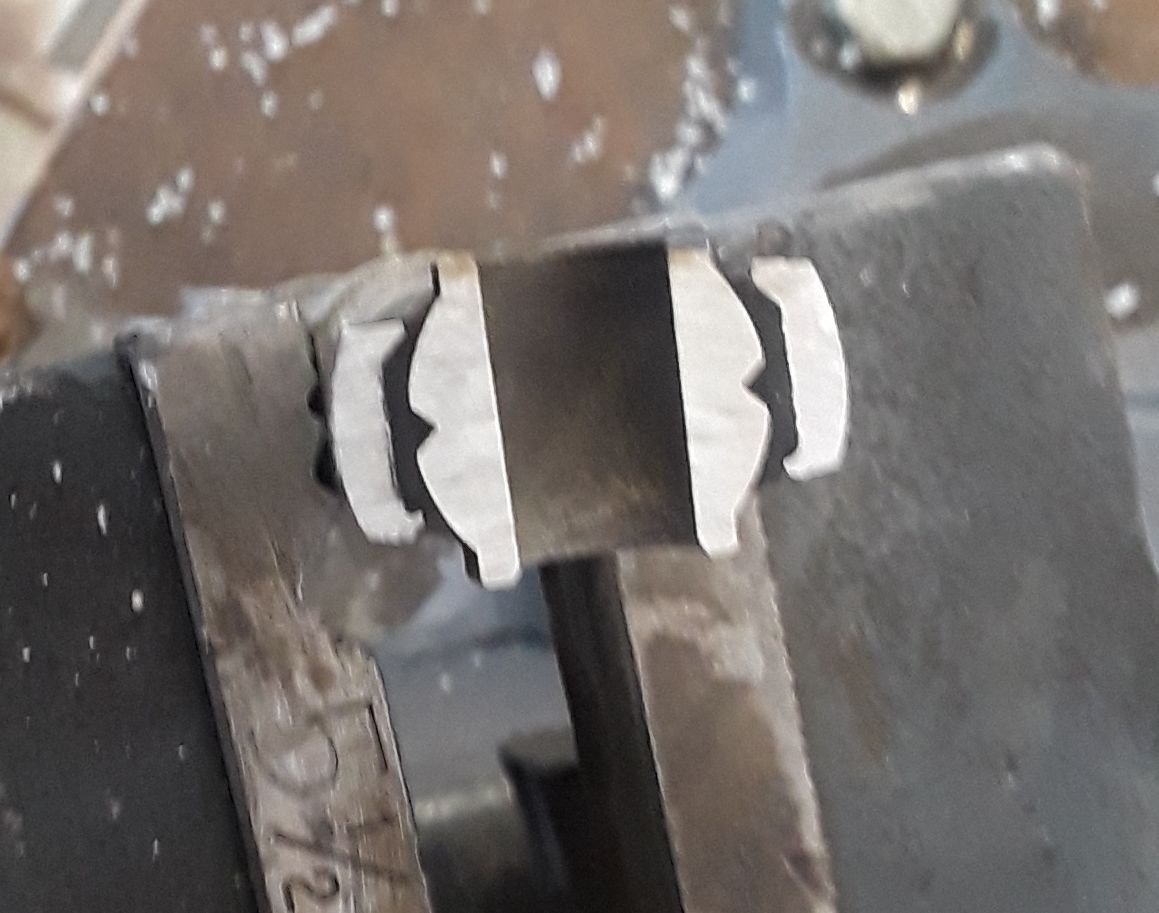

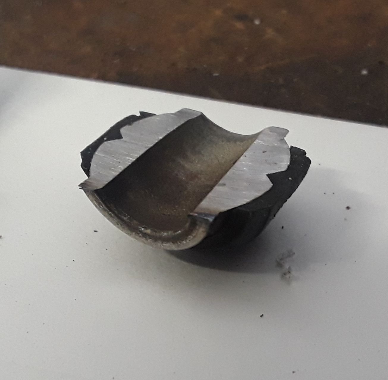

Just for fun, here's what the stock mount on my '90 looks like cut in half.

So it is steel sleeve in a rubber bushing?

Not exactly a sleeve. It's still got the spherical internal part like you'd find in a conventional heim joint (or rose joint, for our Brit friends). But it's got a looser fit, and that clearance is taken up by the rubber bushing.
After 29 years, mine weren't rusted, but I expect that rubber loses suppleness over time.

I haven't cut in to mine, but the sleeves don't move at all
