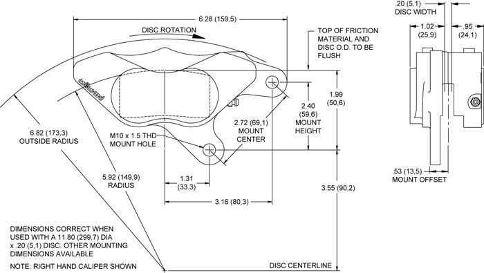

I don't know how much clearance is necessary, but I don't imagine you need all that much. I'd feel fine at anything over 1/8", maybe even 3/32". Maybe even 1/16". That's just a guess.
For comparison, I put Wilwood calipers on mine. The width from the center of the disk to the inboard edge of the caliper is 1.05".
What's the equivalent dimension on your PM's?

I have 4-piston single caliper on my 97 WG with an aftermarket 21" x 3.5" wheel. Does this help? Do you need pictures?
Pics FWIW. Also, Omaha had a question pertaing to distance from center of rotor to inboard edge of caliper ~ 1.14".
that pic is helpful actually. You have the older version with the brackets which looks like it might mount the caliper down and further and maybe a different angle
