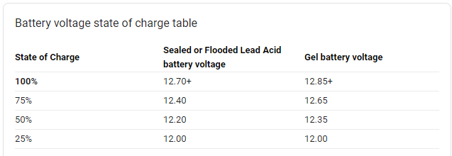

Would like to add that a good battery should show at least 13.5v and with key on 13.2 volts
I have never seen a battery read 13 anything without a charger connected to it...

Make sure you disconnect your battery tender before taking voltage.
A 6 celled battery should read 12.6v at full charge.

I never use a tender... Currently the battery has been in storage in my house since November... Should I charge it first like I always do in spring coming out of storage or should I test a battery that sat for 4 months without being cycled?
You can do both if you want to I was just saying that testing a battery with a tender will read 13+v and a regular agm or lead acid battery should read 12.6v at full charge as each cell should be 2.1v.
