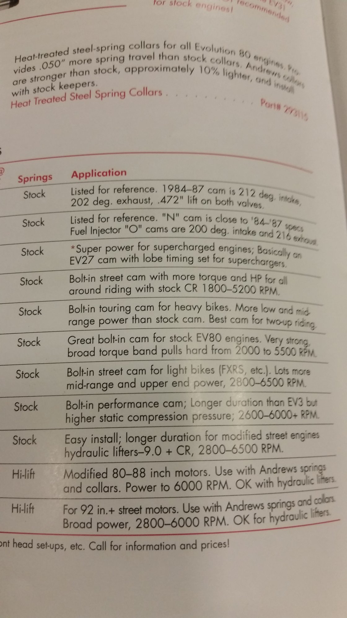

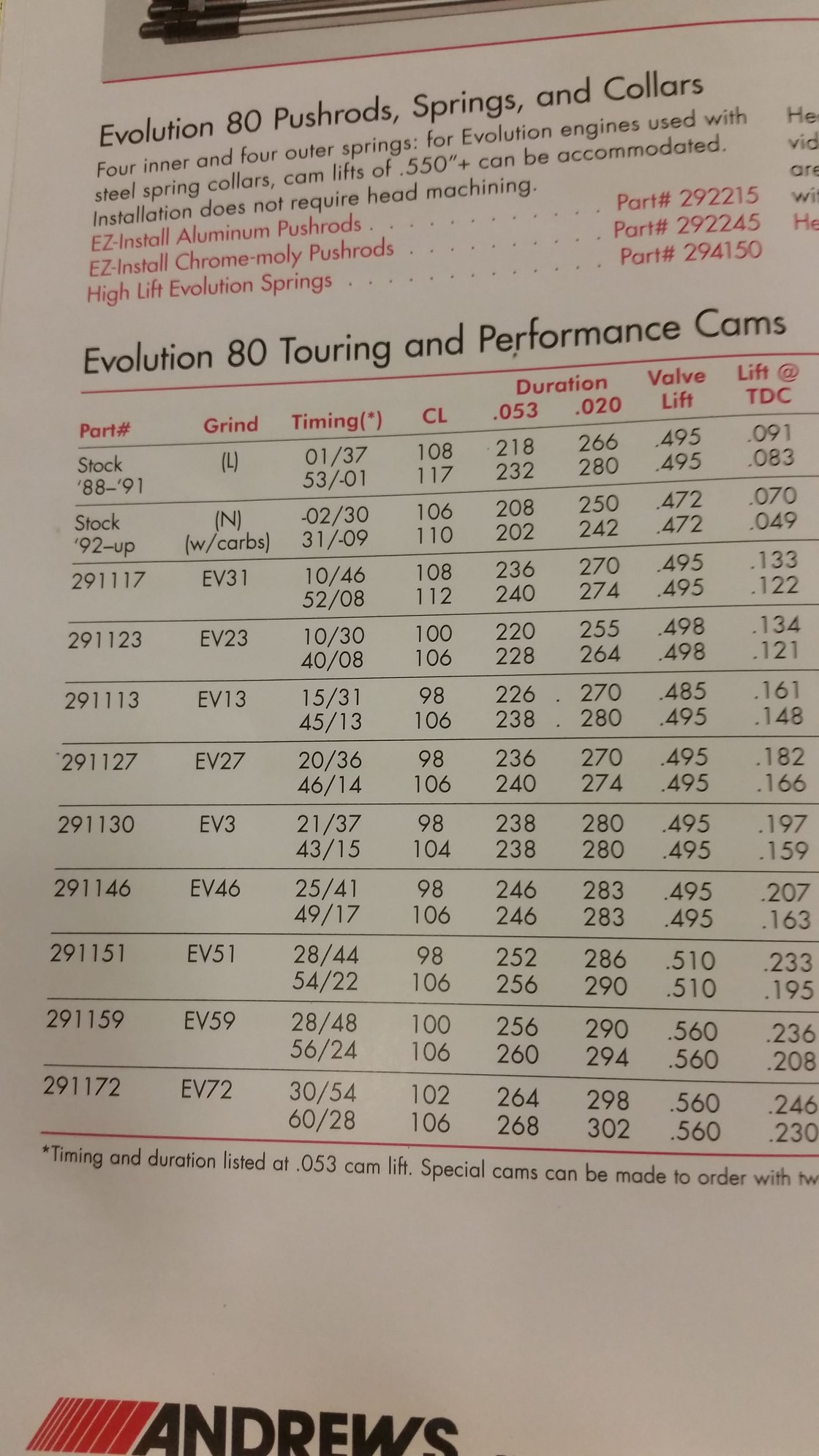

Most guys drop in an andrews EV13 or EV27 cam, the 13 is one of the better bagger cams. You didn't mention miles but if your goin in lifters are a given. I recently put the EV13 in my Dyna n it's a nice torquey cam.

Look for a cam that starts making ponies @ 2000 or so RPM's for a bagger, EV 27 is flat till 2700 and doesn't get strong till about 3400, targets lighter bikes. I'm not a big Andrews fan, check out VThunder cams by Competition cams. A few good choices for a fat bike and I find they run quieter than Andrews. EVL 3000 or 3010 work well.

http://www.bigboyzheadporting.com/EVOcams.htm
This is handy for comparing cams.
