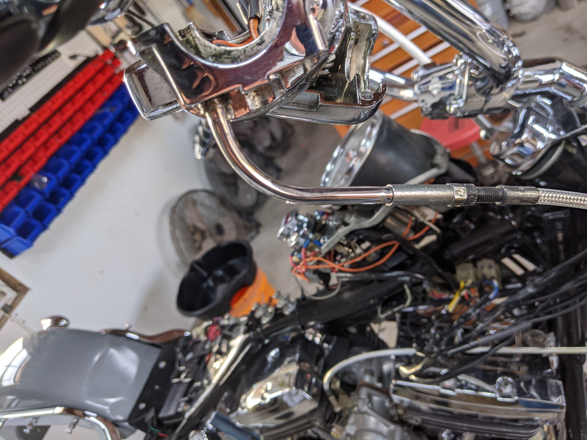

I have the tape hooked on the other end. The part that goes into the carb. I'm needing to get a cable 3 to 4 inchs longer and one that doesn't have a 90 degree bend to match the other
I'm assuming it's woven chrome braided.
My question. A good place to order, what length and bend

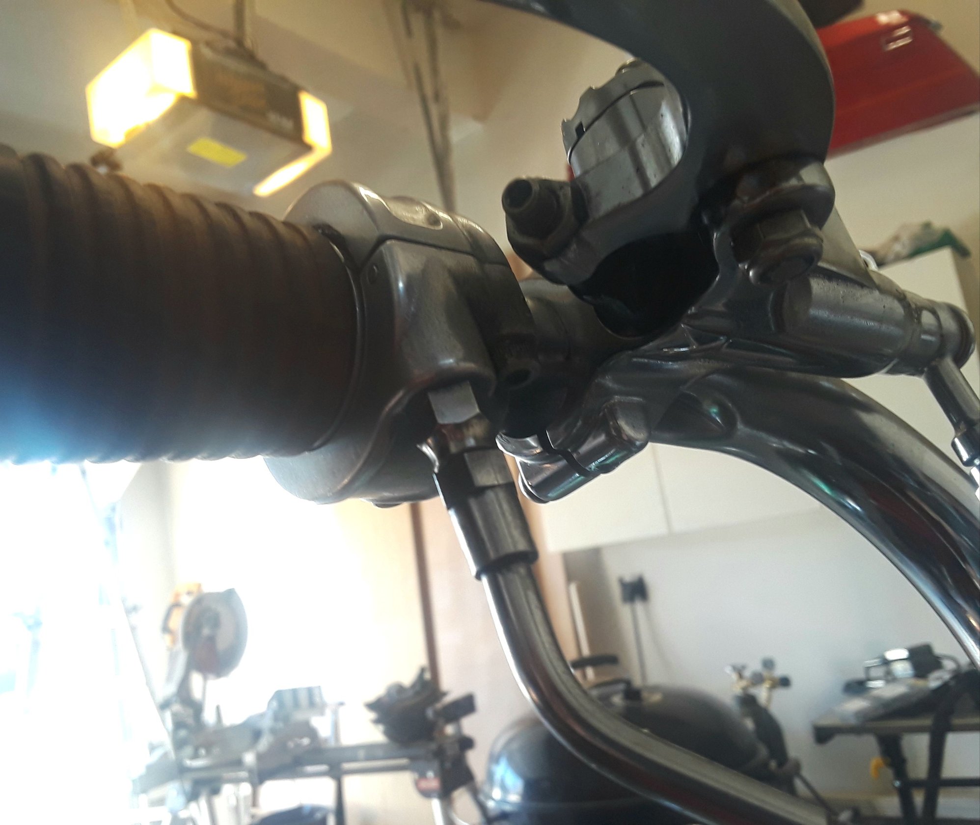

Of the 2 cables currently on the bike, neither is stock length, the throttle is 34" with a 70 degree bend and the idle is 30" with a 90 degree bend, plus since both cables are using cir clips to hold them in place they have to be 1996 and newer.
Like I mentioned many times about this bike, damn near everything has been changed from stock so this whole rebuild is one big learning curve.
Dennis Kirk has a drag specialties 32 1/2" with a 70 Degree that should be a fitter, BUT I'm probably better off getting one that matches the throttle in case I opt for taller bars down the road.
