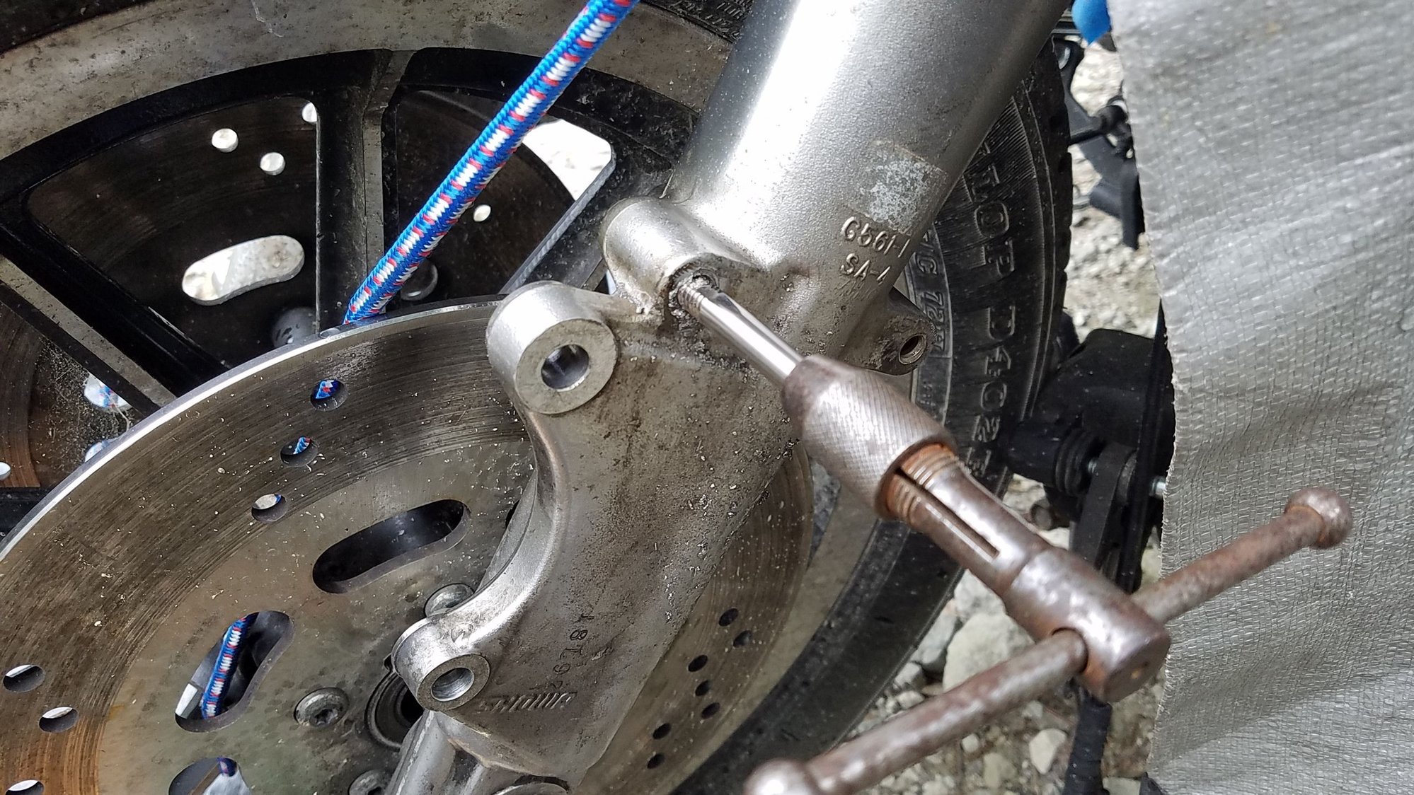

So far have drilled with 1/8, 3/16, and 1/4" reverse drills. No back-out. Used small chisel to break off 3/16" depth of remaining bolt shell around outer edge of hole to access existing threads. Got about 1/4" tapped, very slowly, breaking chip often with 5/16 tapered tap. Will follow up with bottoming tap. Slow process. Waiting for wet stuff to stop falling. Ken

Tapping it out
Success!

Wow, you should have covered the parts below...or removed them, but it`s your bike. Chips are nasty....
No parts to cover below...axle reinserted during drilling. Not many chips flying around when drilling Grade 8 steel in a hole.. Calipers, etc.removed. Most all small pieces ran directly out of hole and dripped on ground...used lots of thick drilling lube. Ken
