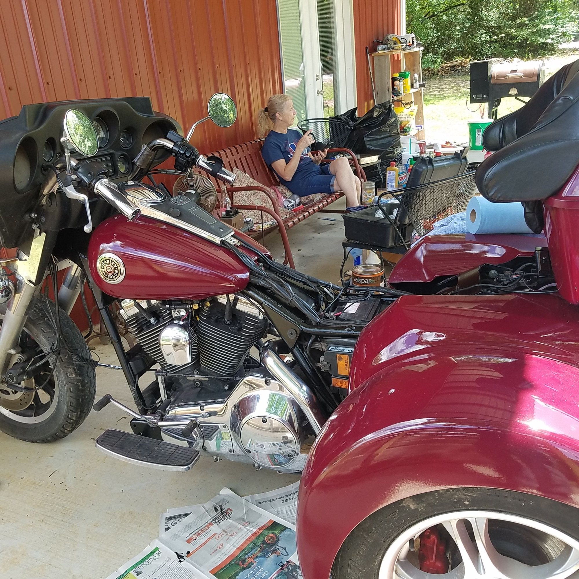

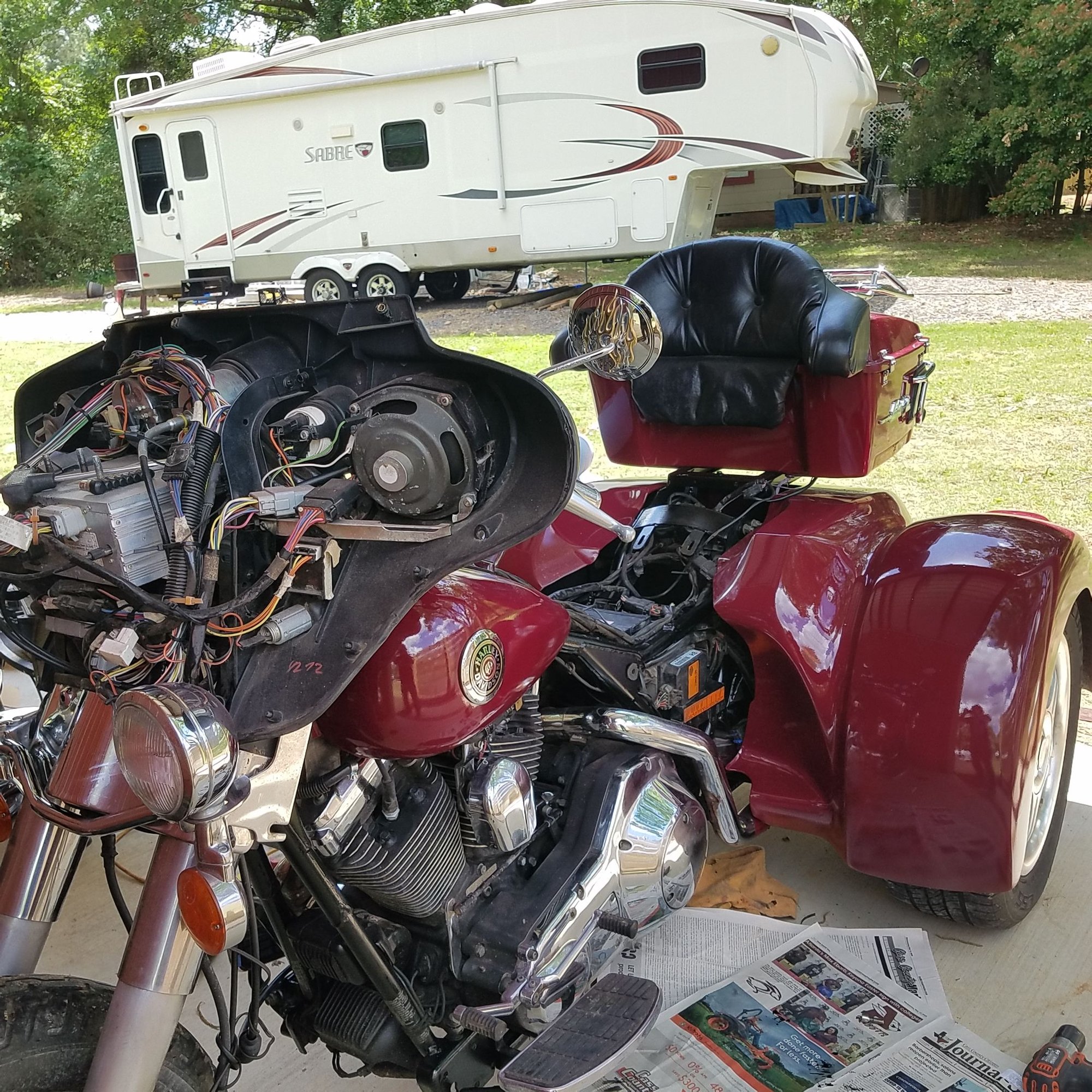

Originally Posted by Superdog3:16
Gotchya! When ya get a chance, pic?!
Here's a couple for ya!
Old May 23, 2020 | 09:33 PM
evotrike's Avatar
evotrike
Joined: Jan 2019
Posts: 1,126
Likes: 923
From: Texas

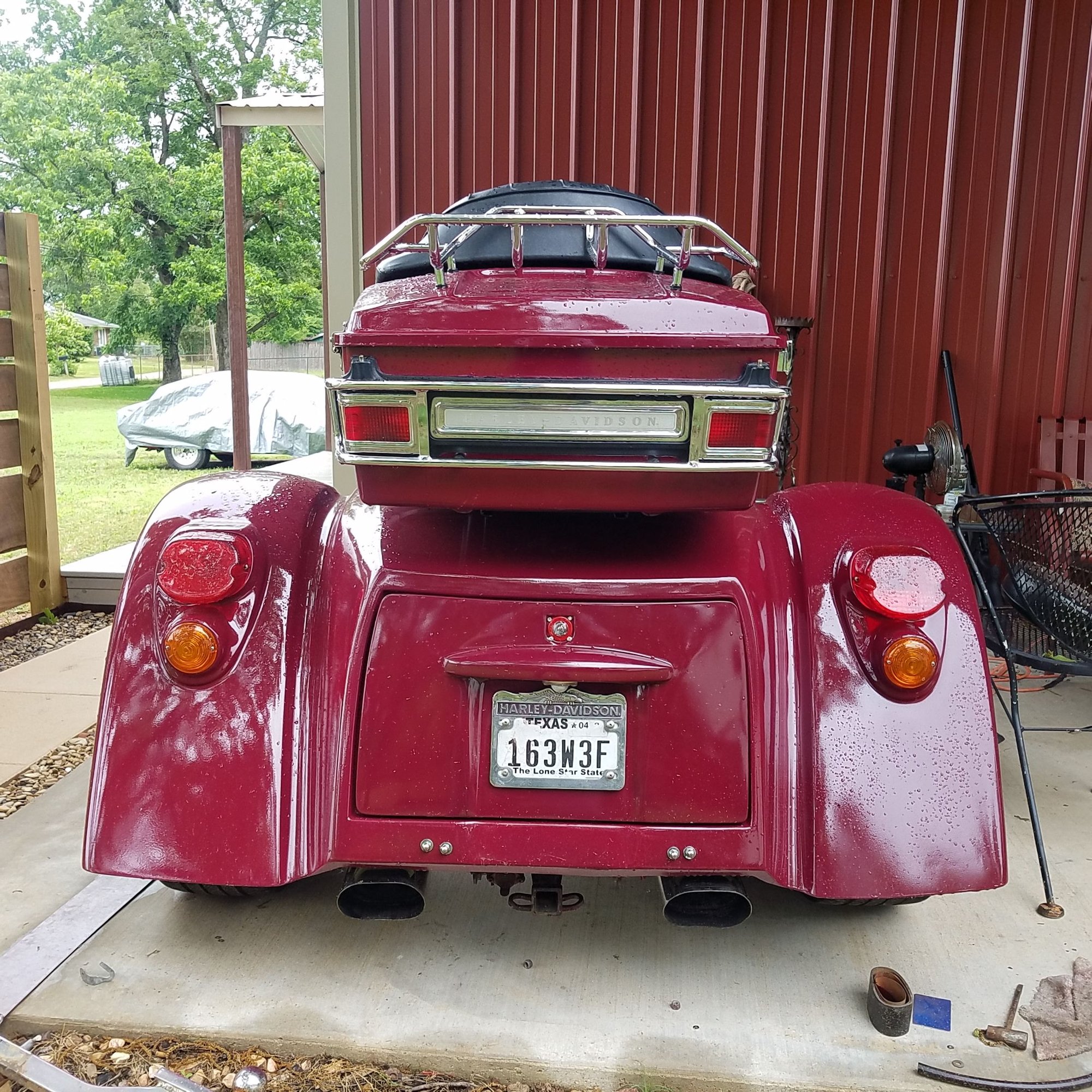

1 more
Old May 23, 2020 | 09:40 PM
Superdog3:16's Avatar
Superdog3:16
Joined: Nov 2018
Posts: 3,421
Likes: 726
From: Tiffin,Oh
Thanx! That's badass!

Well, after a lot of lookin' and cussin' ( and a couple of extremely cold Shiner Bocks in the bottles), found the problem. Instead of testing back-to-front, decided to start at the source. Pulled all ground stud and main circuit breaker wires and battery cables and cleaned up. Then went to ignition switch and tested according to the manual.
2 wires come out hot on ignition setting, both tested hot. Followed both to interconnect harness plug-in. Tested both wires on other side of plug....one had no juice. Plug pin was green. Cleaned all of them, and now have all lights.
