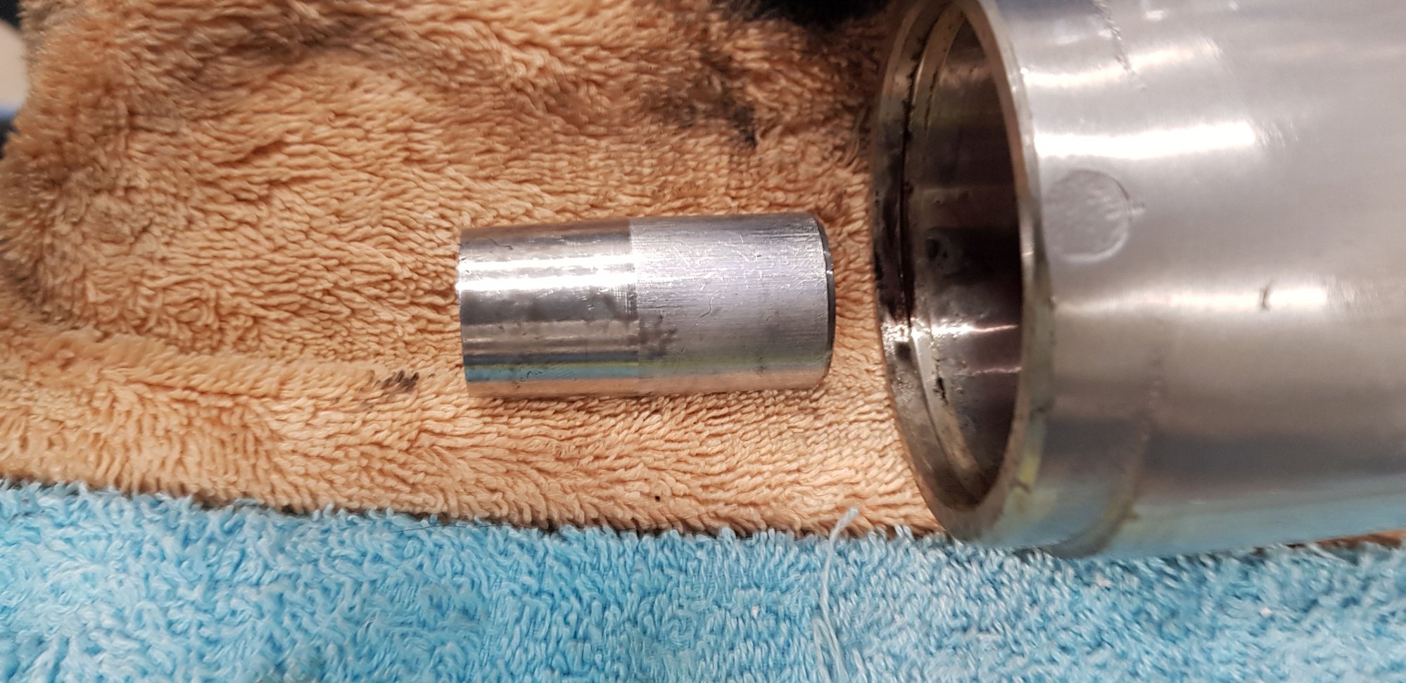

I pulled the forks down today to replace the oil seals and put the progressive springs in...... Everything went pretty straight forward until after I removed the spring and placed fork on the bench and this part fell out. (Picture 1)
Now I wasn't sure how it goes back in and some videos showed it going on the end of the damper tube as it was extended fully out, but that was for a dyna so it might be different.

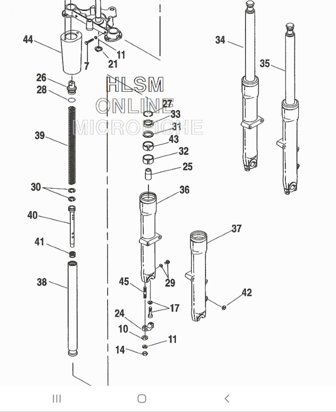

I pulled up Ronnies parts and the part I'm talking about is # 29....... how do I get it back securely in the right place? Does it come in from the top or from under?

It goes on the end of #40, inside of #36. Put it on and slide the entire assembly into the lower leg. The bolt from the bottom #17 holds it all together. Good luck.

Unfortunately that diagram isn't very helpful - I've had similar problems deciphering it! I think you will find it is #25, your confusingly named 'LOWER STOP'. It should fit on the end of your damper rod, in your lower photo, and is trapped inside the fork slider when tightening the allen screw in the bottom. It is some time since I last messed with it, while installing Ohlins cartridges in my forks, so memory is a bit rusty - I had to machine mine to make them fit, but that is another story.

Yep that goes onto the end of the damper tube.
The damper tube fits into it like sticking your finger into a cup.
The way to reassemble is to have the fork spring in place then invert the fork tube, put that piece on the end of the damper tube, slide the lower leg onto the assembly, at this point you will probably have to use a screwdriver to line everything up, and finally screw the bolt (part 17 in your diagram) into the damper tube.
Then you can flip the whole leg and install your seal and keeper.
Finally you can either put the fluid in now or after you put the leg back into the trees.
