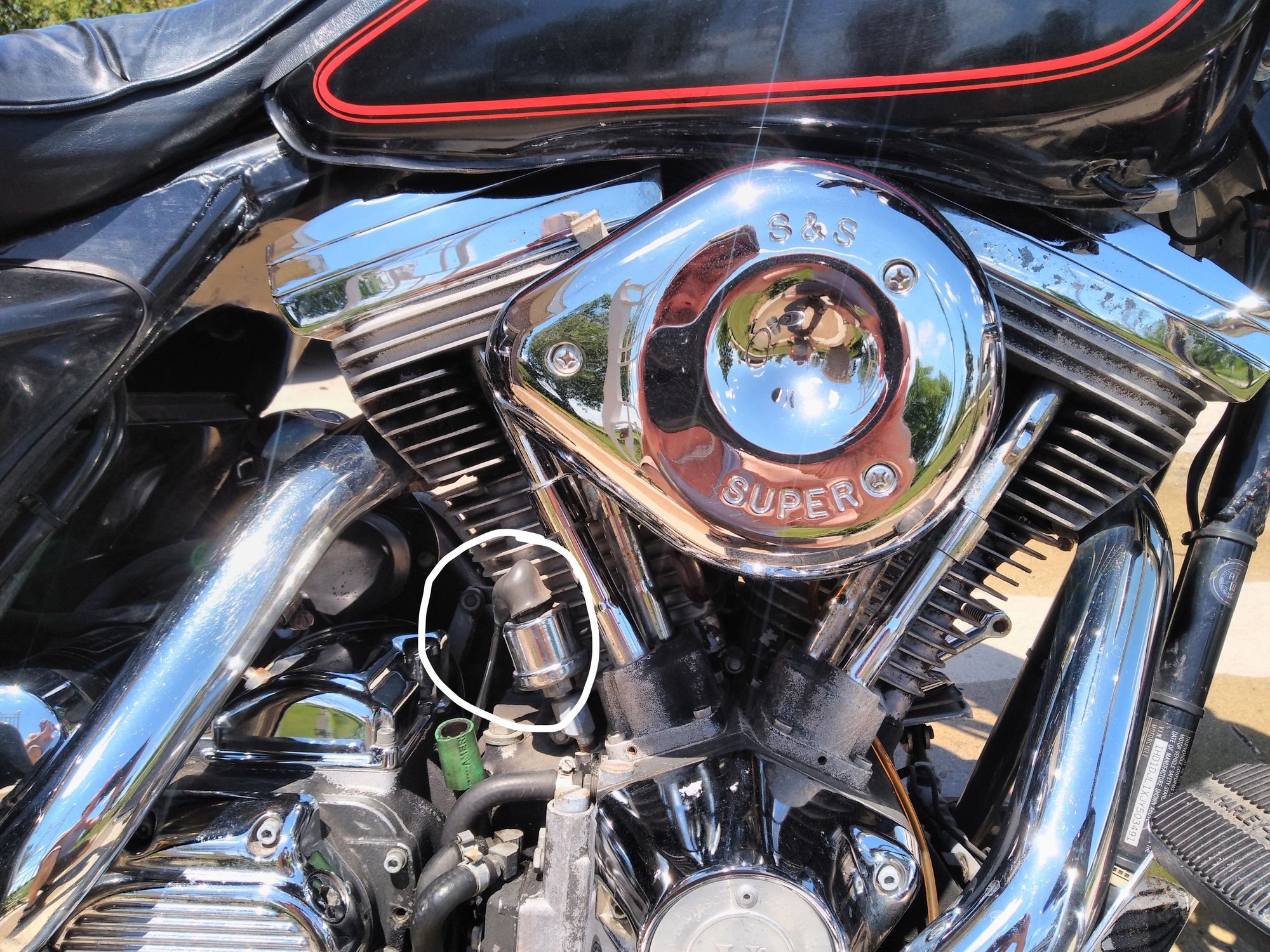

Hello all you intelligent HD peeps! I have two simple questions. First, what is that? An oil pressure switch??? Second, where do i get one? Thanks everyone sorry for the giant picture...

Oil pressure idiot light switch and pressure sender for the gauge. There's a recent thread on them. They are NLA.

Oil sender. Part # 74406-87 or 74406-86 (same part) Two posts - one for the gauge, the other for the light.
And, if you hook one up backward, the instant you turn the switch on, gauge side of the sender is toast.

so where should I get one? Aftermarket??

I just checked with my parts girl, the 74406-87 sender is still available from MoCo. It's the oil temperature sender that's obsolete.
Some of us prefer to keep our stuff factory correct and functional. As to whether we use a particular feature or simply have them present for aesthetic purposes, is each one's individual choice.

Thanks for the info. What's MoCo? Who should I talk with? Or online I'm guessing.

Motor Company...as in Harley Davidson Motor Company.
Any authorized dealer should be able to help you.
