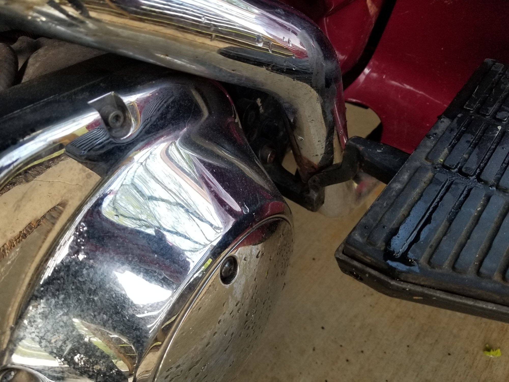

Don't know about your 92 ultra, but on my 98 everything is quality steel up to the floorboard. I cut and made a 4" riser of 1/2" square, You should be able to take it to a weld shop and get it done, or do it yourself. Late but will try to send a couple photos in the morning. My OL also is short, so it was a must.

I just cut where I had enough to use the existing swivel base for the floorboard.

Had to get fancy on left side exhaust. In retrospect, should have just extended frame mount piece farther and miss the header pipe. Ken

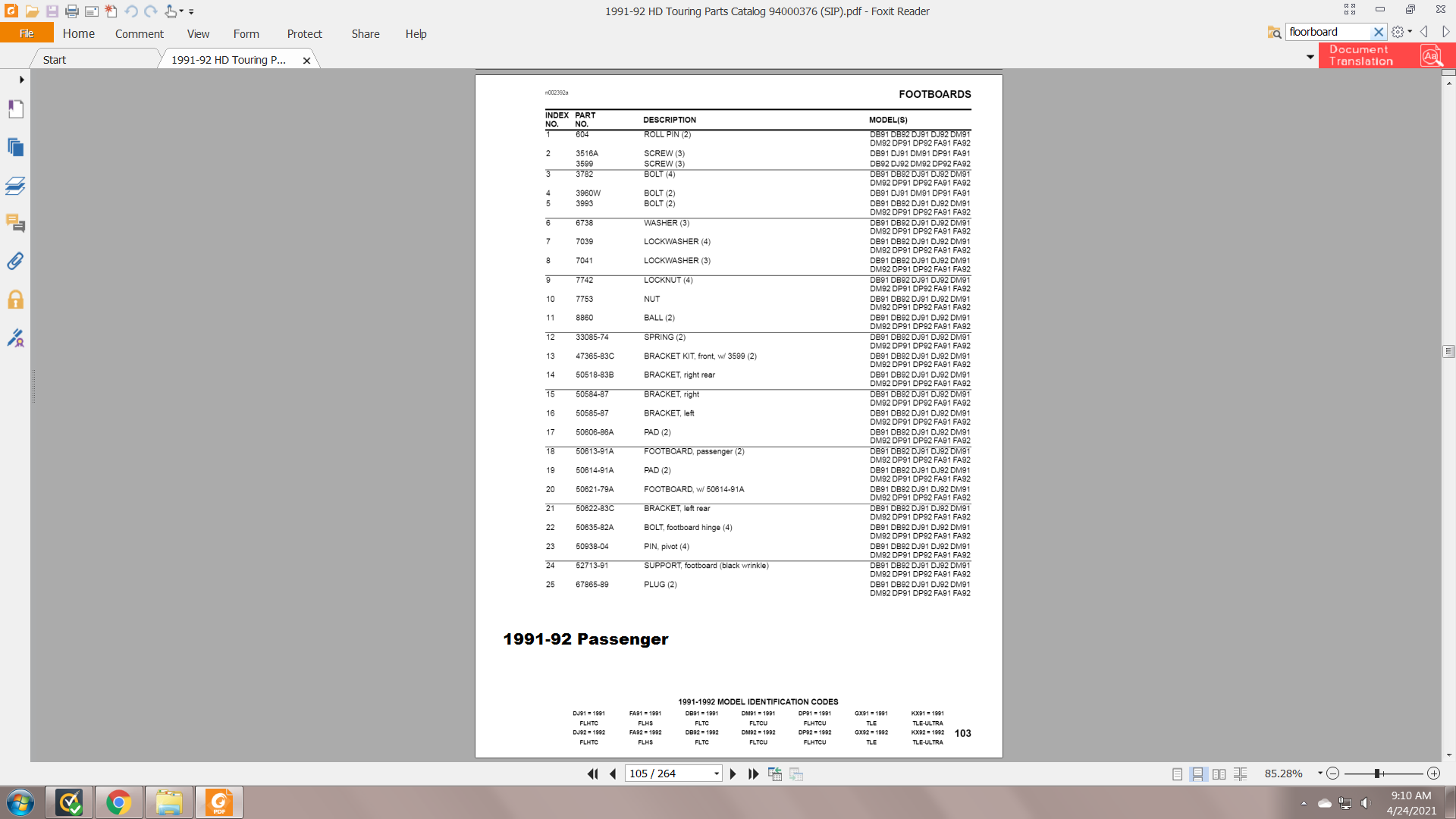

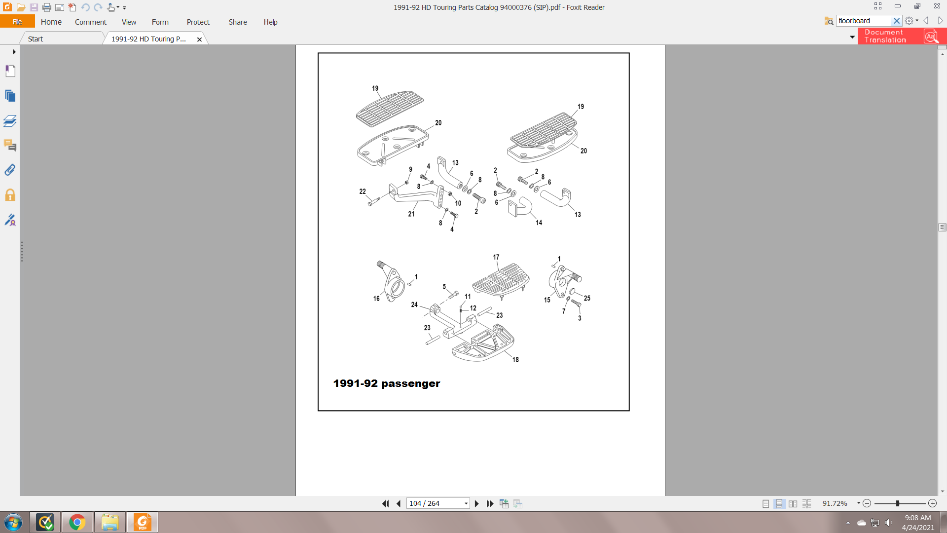

Evotrike has an idea ... Maybe find a pair at a Swap Meet or check the price and availability ( 52713-91 ) through a dealer before "altering" yours ... Just in case ... Good Luck

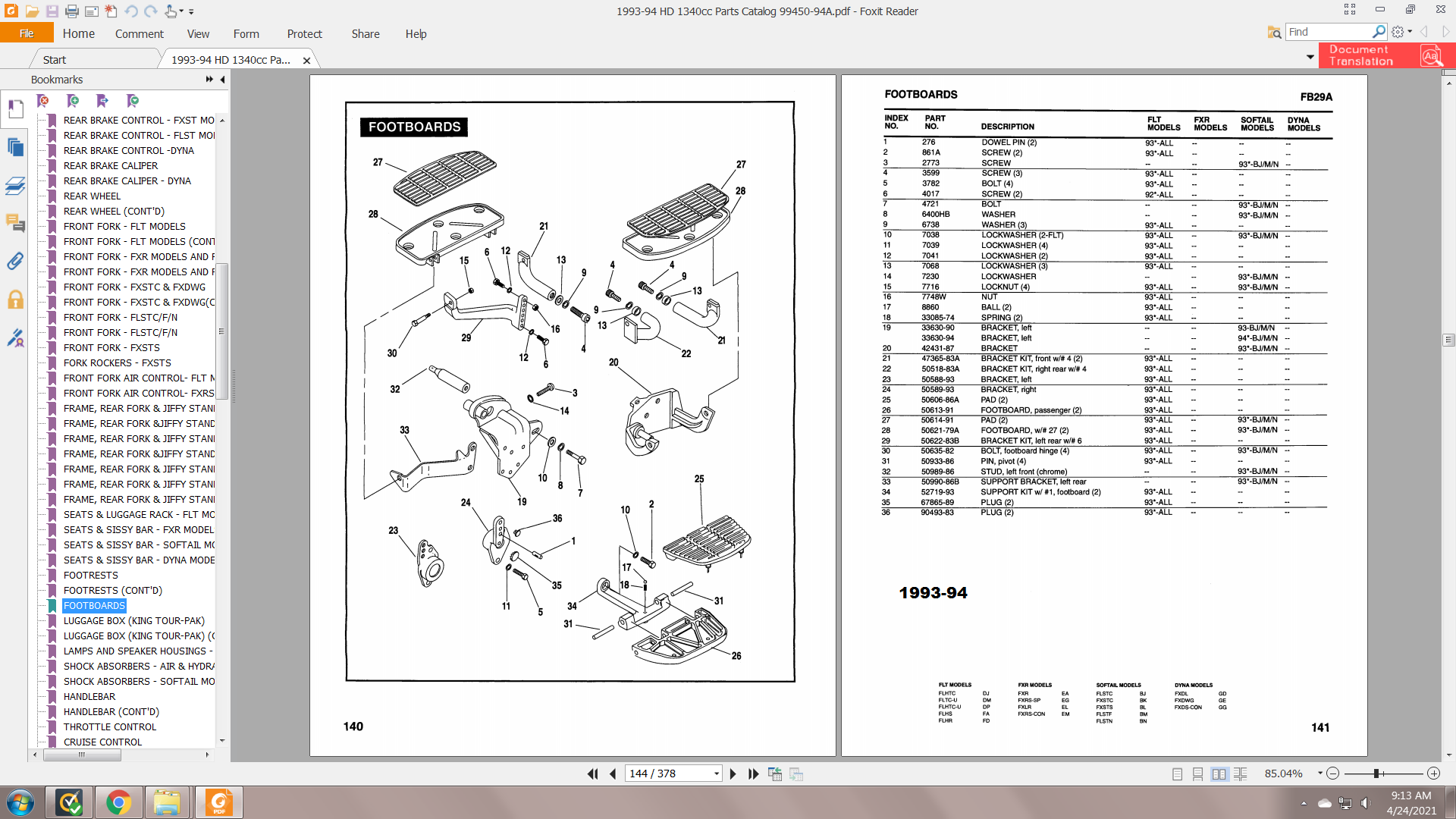

So my ole lady is 4ft6 and the back of her knees ride on the rails and her feet dont reach the boards or barely does anyone know have a link or have a suggestion on how I can the passenger floorboards for a 92 Ultra there's nothing available as far as I can see before 93 and I don't want to pay $320 for a Kuryakyn something or other I don't know
help?
You can retrofit the late model ones, bolted right on my 87. The world opens up then.
