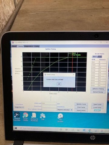

Curve loaded!
Modified the t150vej procedure slightly for future reference:
PC on > cable connected > Ignition ON (with lights) and RUN switch ON > Start Curvemaker program!
I feel happy and stupid, so call me stupid happy or happy stupid. Glad it was simple, SO THANKS EVERYONE!
Just a few notes for anyone else: I did disconnect the red power wire to the wego unit, but did not need to disconnect the brown tach wire that the wego unit uses to pick up the tach signal for data storage. I will try again with the curvemaker program and the wego unit connected to see if that will create any problems with data transfer.
Also, I was running a led vacuum advance mode indicator light, but I removed that when trouble shooting earlier today. I read a post on xl forums that the "simple" LED indicator (some people use) interfered with the data transfer process, so I removed mine. However, my LED circuit is different in that it is isolated via a separate transistor with the gate of the transistor triggered by the VOES and using a separate power source and ground, so it should work without interrupting the data transfer, and will try again after I reconnect the LED indicator this weekend.
